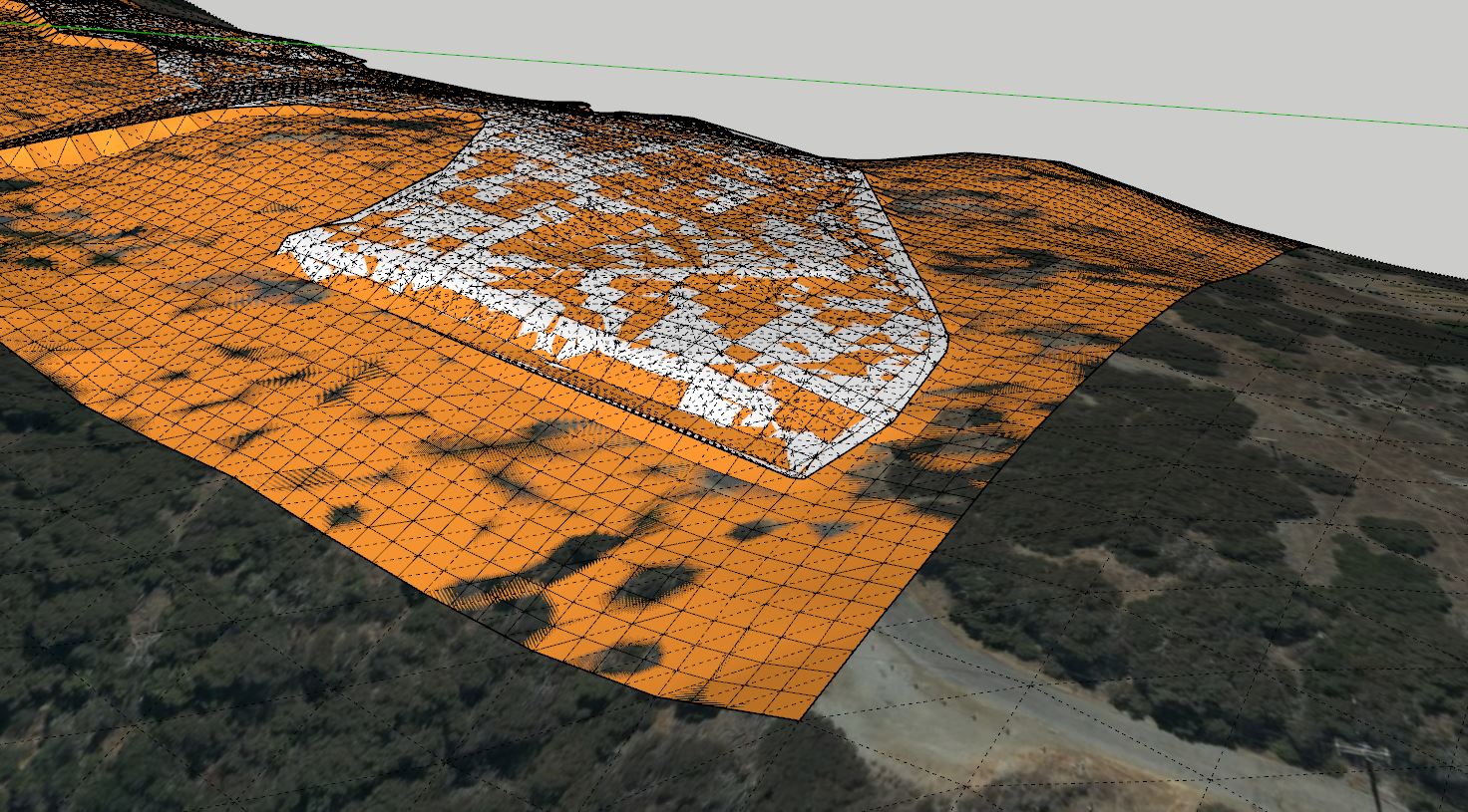

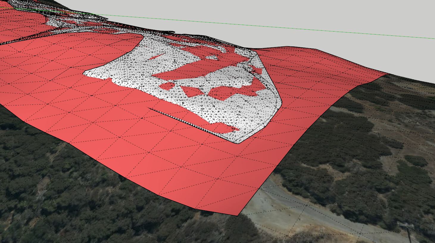

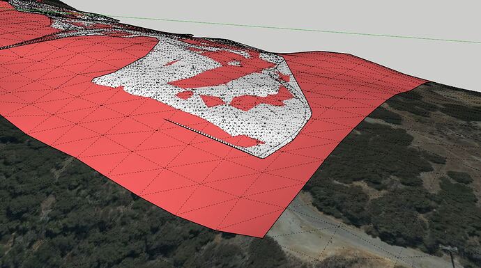

The idea is to get a surface with more faces/vertices to be able to capture more details from the survey surface.
less faces/vertices > less details
more faces/vertices > more details - a smoother surface and closer (and cleaner) in shape to the original one
