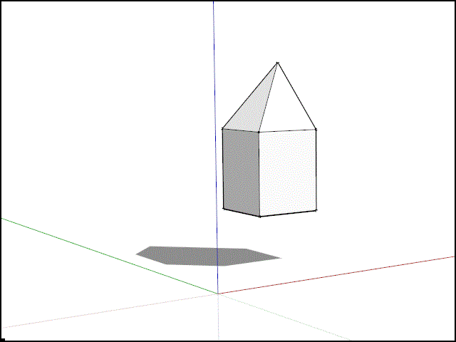

If you have a change in the shape, pushpull can’t go beyond this border and you can’t enter a greater distance…

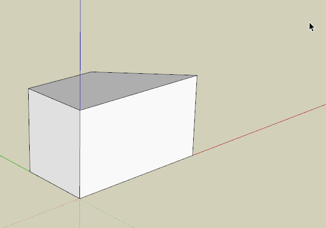

Many of SketchUp’s tools have extra functions enabled by pressing a modifier key.
Keep an eye on the Status Bar at the bottom left of the model space for modifier key tips.
For the Push/Pull tool, press the Ctrl key to start a new face.
Notice the little + sign that appears near the tool cursor
