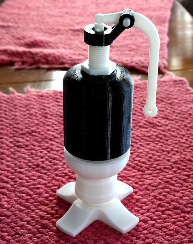

My daughter and grandsons got me started on 3D printing which we can do at 3 of the libraries here in Colorado Springs. So, I found an old file I had done on a Friday at Noon session with Aaron.

Fun to draw and hopefully fun to print. I’ve broken it down to seven elements. The big challenges are the 4 struts, and that is why I am preparing a thicker strut version. We’ll test the 4x4 version of the struts first. I’m learning a lot, and it has been a lot of fun. (Also a lot of printer sitting; reminds me of when Houston Instruments’ pen plotters came out. My partner and I would take turns “plotter sitting” - hoping that a detailed floor plan on a 24 x 36 sheet would make it.)

I’ve thought about it and might do it one of these days. I did 3D print the steam whistle model I made.
And a U-joint from about 1905.
