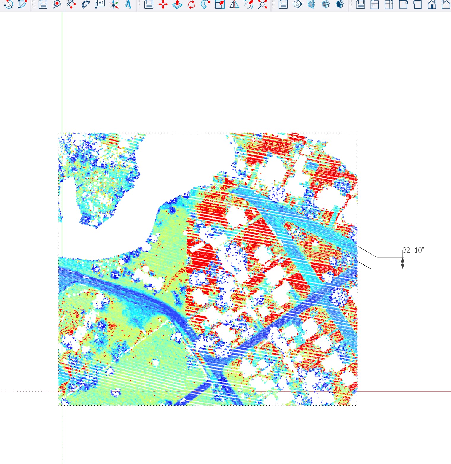

That’s strange. I’m getting a measurement of about 10 meters across the street, which converts to 32 feet 10 inches when I switch the units to feet and inches. This occurs when importing into SketchUp 2024 using the Undet Point Cloud plugin.
- With Undet for SketchUp - the initial point cloud data must be in the metric system when you create the project.
- The scale of the point cloud can be changed by selecting the SketchUp template: metric, inches, or millimetres.
