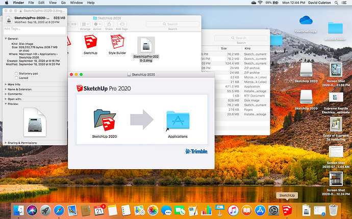

I downloaded what was supposed to be a 2020.2 and it was a file type of “disk image” or “.dmg”. When I click on it, it says it’s going through a “verifying file…” procedure and then instructs me to go back to the file folder. I click on the SketchUp program icon and it still opens 2020.2
You may be misunderstanding the installer. When the .dmg opens (the verification step is macOS checking it’s signature), in the resulting window you drag the SketchUp icon onto the Applications folder icon to do the install. SketchUp 2020.1 must not be running when you do this else the install will fail.
They could have made it a lot easier if they just wrote the words “Drag Sketchup icon above into applications folder to the right to begin install” or just have it happen automatically!
