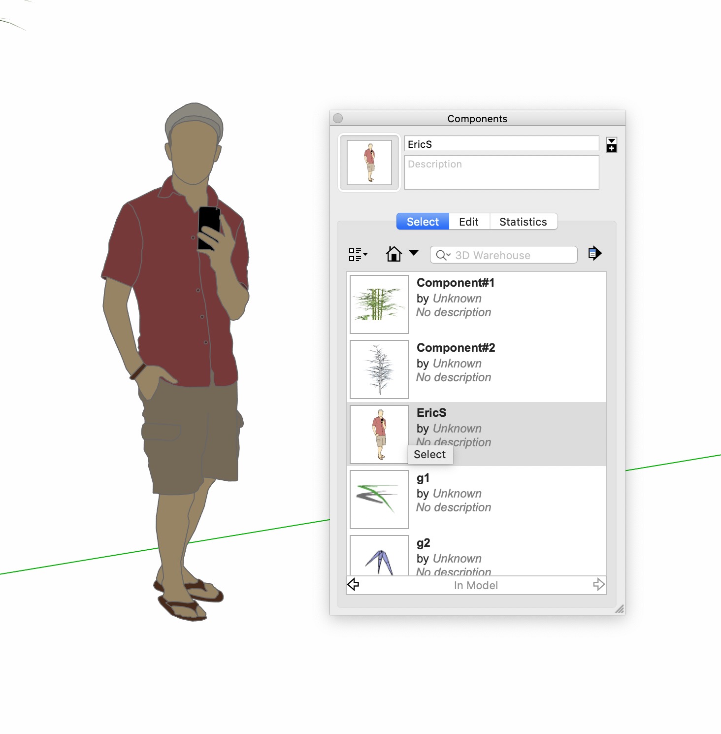

Yes. You can do this in the component browser/panel.
  1. first make sure that you are showing only components ‘In Model’
  2. Then select (in the browser window, not the model) the component you want to check.
  3. Then click the ‘Statistics’ tab…make sure that ‘Expand’ button is checked as well as it counts nested groups/components.
And for fun, here is some bamboo in my model:
Also, I’m sure you’ve seen this but make sure to check the models polygon counts in 3D Warehouse before downloading. This one tree has 11 MILLION POLYGONS in it. Wow.
