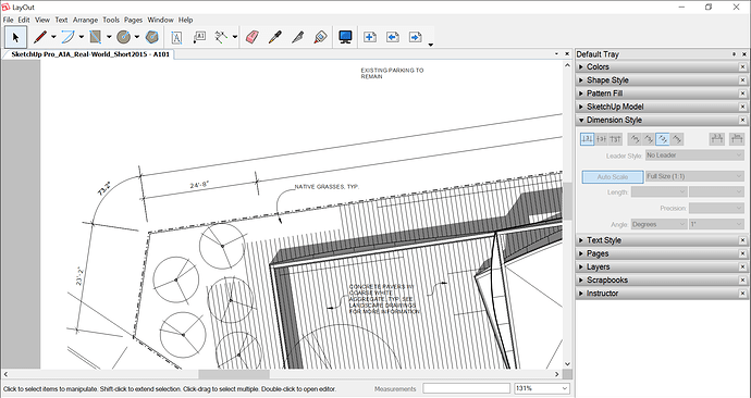

One that bugs me that I would like to see brought to the Mac is the control of the palettes.If you look at the far right of each palette there is an arrow that allows you to manipulate that particular palette. I want that kind of control on a Mac.
On Mac you can dock the palettes together and collapse or open them by clicking on their title bars. In fact on Windows the arrows are really necessary because clicking on the title bars there does the same thing.
It is possible to tear them apart on Mac more easily than you can create separate trays on Windows. If you used the Mac palettes in the same way you use Trays, the effect would be the same as in Dave’s Windows screen recording.
Windows does have the advantage of being able to scroll through a lot of expanded trays, on Mac you would need to collapse the upper ones to be sure of seeing the expanded off screen lower ones.
