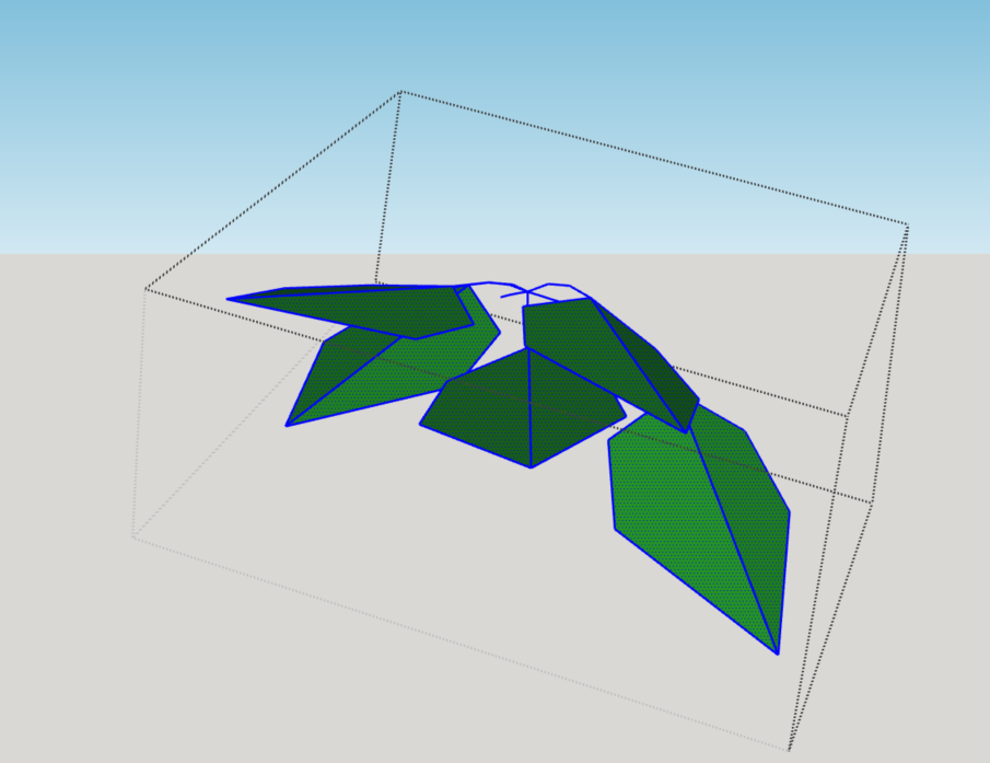

Allow me to elaborate:
Say I downloaded a plant from 3D Warehouse and I want to change all the leaves to dark red. I double-click until I see that each individual leaf is colored green. I want to change the material of each leaf to Default so I can escape out and change all the leaf colors at the same time.
I select all the leaves with a crossing or window.
I click on Entity Info > Material Info
I choose Default.
Rotating up, I see the bottom surfaces have not changed. But on the right, I still see the Default icon in the Entity Info.
But when I individually select one surface, it shows both sides of the surface in the Entity Info box.
Is there a way to actually select all surfaces when selecting everything and trying to change the color?
With a complete explanation it is much easier to make a recommendation. Try using ThomThom’s MaterialTools to remove the materials. Or as I suggested earlier, you could just delete the material from the In Model collection. SketchUp will replace the material with the default material.
