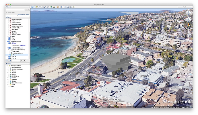

Here is a simple model as example that’s been geo-located. It sits on an existing building that will conflict if I sent it to GE.

Lastly, if you’re still struggling to line things up there may be a difference between the camera FOV between SU and GE. Check this site out for KMZ files that can change the FOV so you know for sure what to match in your SU file.
For example, this is the exact same placemark after loading the 45 FOV kmz:
