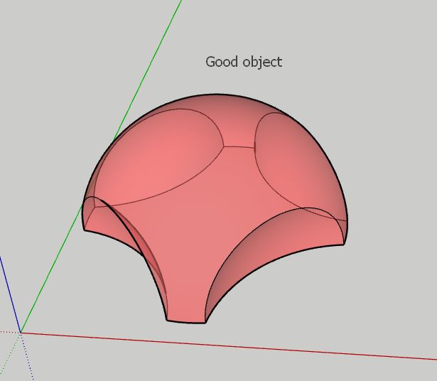

Hi. I have a damaged object I would like to replace with good one I copied from another file.
How do I get the damaged objects coordinates and how do I locate the copied one in the same coordinates of the damaged one?
Attached are two files. “Dome” is the good object and “all” includes the damaged object.
Thanks.
dome.skp (1.0 MB) all.skp (4.5 MB)
![11|573x500]
