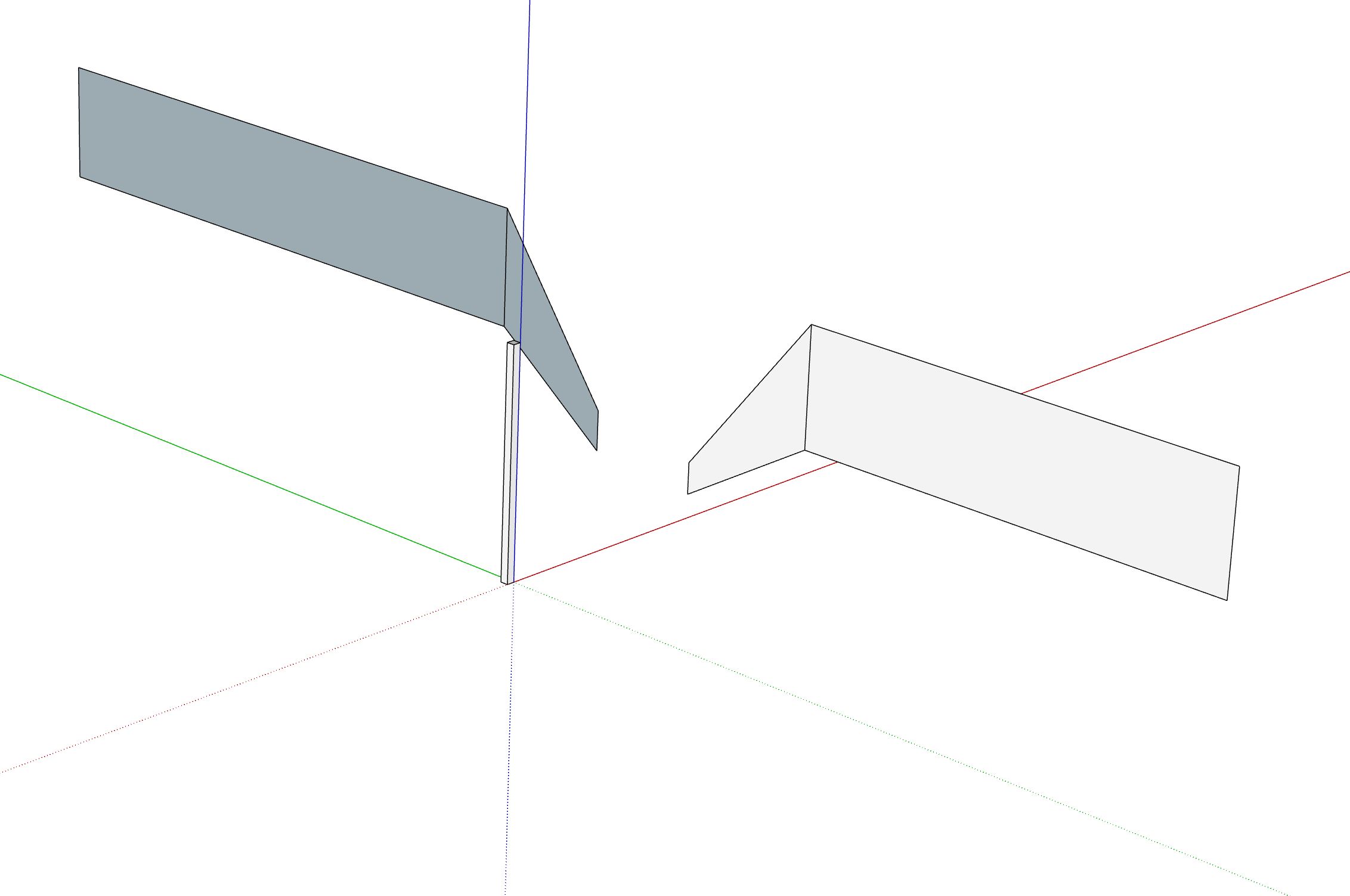

It shoud reappear when the the scene is clicked on, I’m sure that’s what’s happened in the past
You can see the scene is correct, but no photo showing
Yes. It should reappear when the scene is selected.

Your selected style has the Foreground and Background images off in the style so it’s no wonder the image doesn’t show. Turn them on and update the style or select the Simple Style from the In Model styles.
