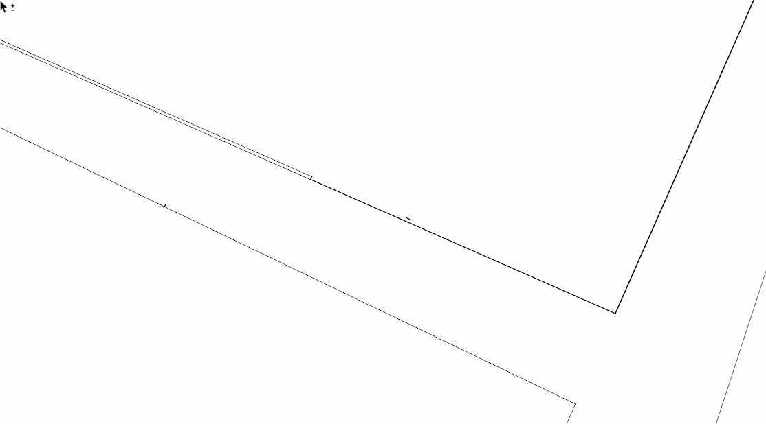

The perimeter of the mater bedroom needs some attention. Notice the thick edges in my screen shot, above. If you zoom in on the corner you can see there are a number of short edges and doubled up edges.
I would suggest erasing all of those edges and redrawing that room. Also look around for other stray geometry.

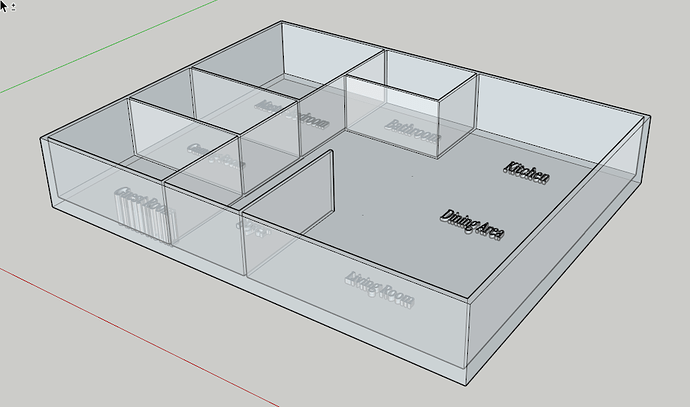

Okay, thank you so much! I did the suggested changes, and the whole house is able to push/pull. Thank you so much for your help!
