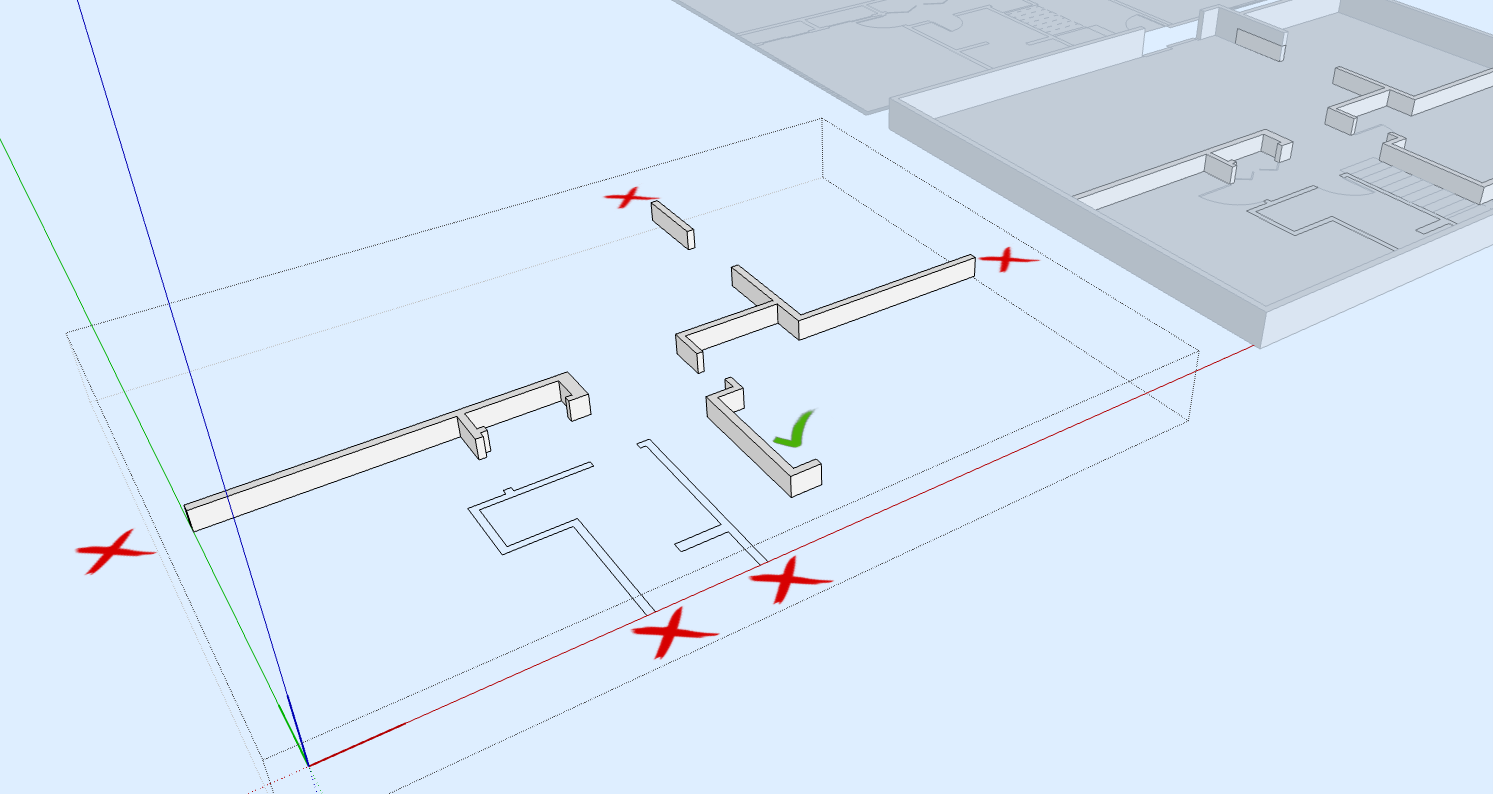

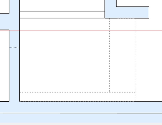

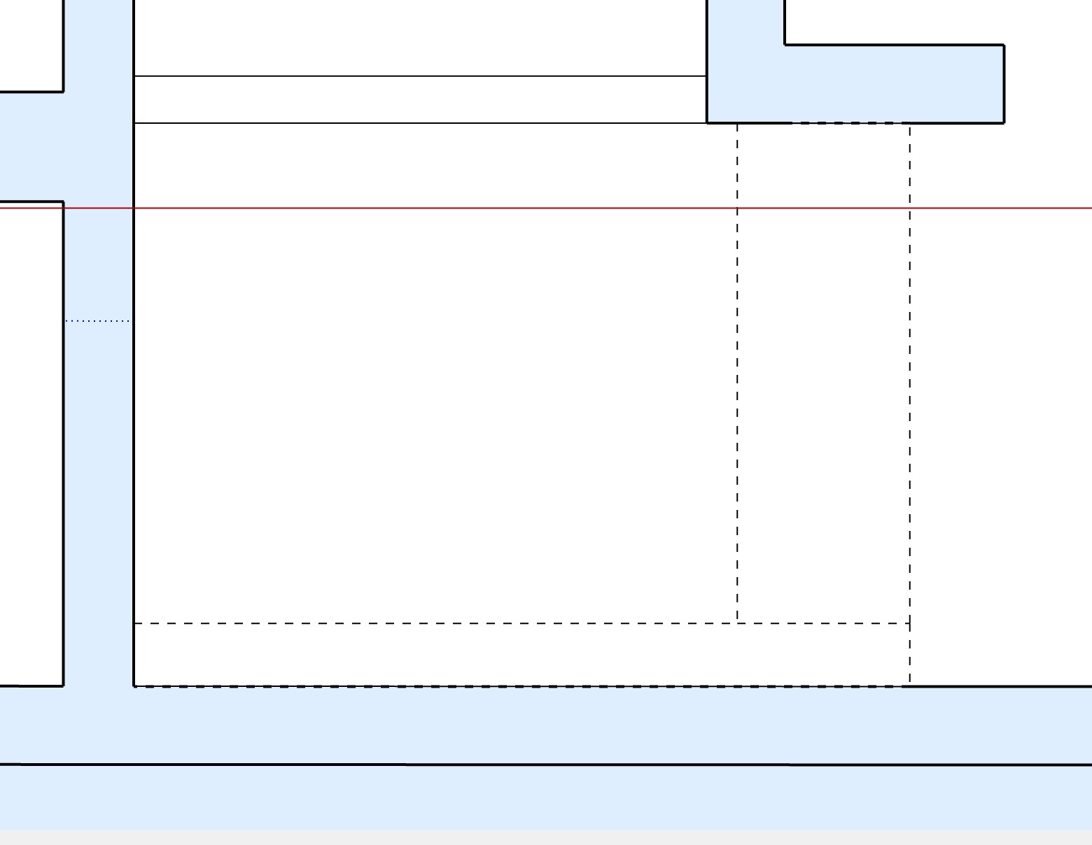

I am pretty new to SketchUp, and I am working on my first 3d floor plan, made from a 2d floor plan I just finished up. However, I am having trouble pushing/pulling the walls on this model. I believe that the problem lies around how I laid out the stair case on the model. I used dash lines to show the part that is on the first floor (this model I am working on is of the basement). I think that the dashed lines have created a ‘break’ in the face of my interior/exterior walls, and therefore there is no solid face to pull the walls from.
I linked photos to this post so that you can see what I am talking about.
Is my thinking on this correct? If so, how do I fix it? If not, what is going on here?!
I copied your ‘base int walls’ component to the left. All (but one) internal walls are open at the end where the meet the outer walls. I corrected (closed) three out of five to get a face to pull up.
(you may need to trace one or two edges to obtain faces)
