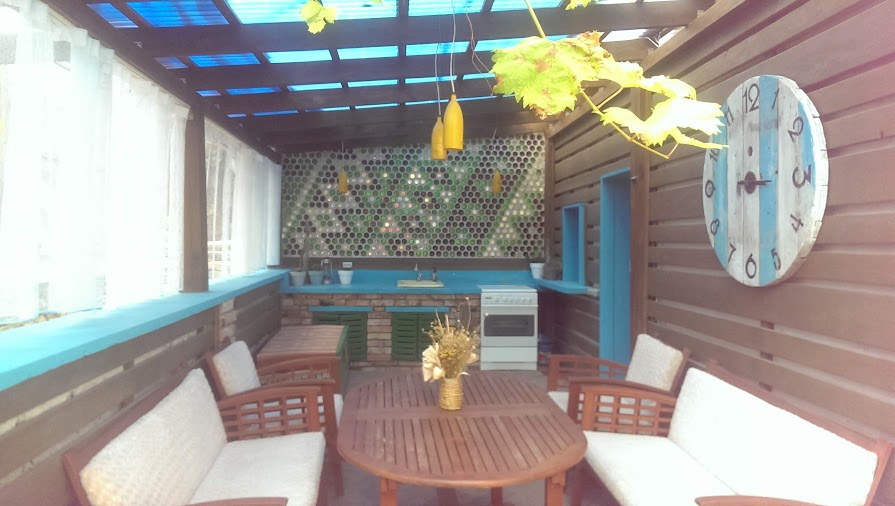

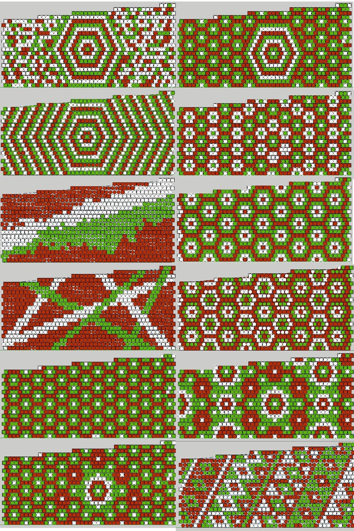

I decided to build this bottle wall because this place faces the sunset, and I imagined that when the sun goes down, the light would shine through the glass and create a unique visual effect.

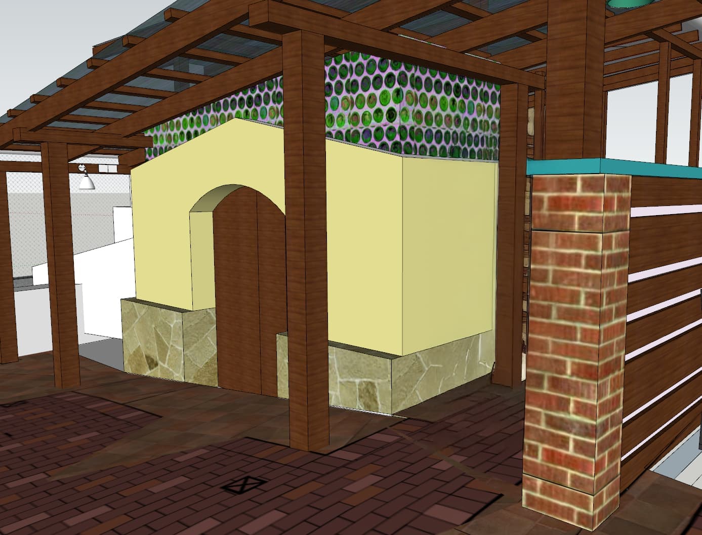

To plan the layout, I modeled the wall in SketchUp and used 3-color circles (to represent the bottles) to test different ornamental patterns.
The final pattern is loosely inspired by traditional textile and carpet motifs from my region.
I usually find that my best design ideas are either the very first or the very last one—after many iterations. In this case, it ended up being the last 12th version that felt right.

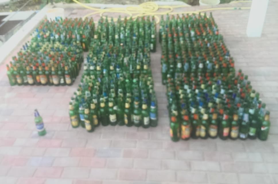

Collecting the bottles was surprisingly easy. I posted a few ads online, asking for donations of10- 50–100 bottles, and eventually gathered what I needed.
I washed the bottles, printed the final version from SketchUp, and got to work.

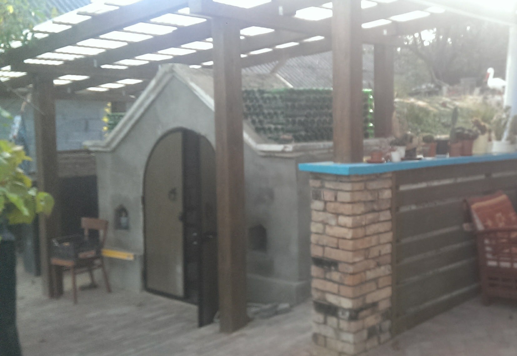

Here is the final result:
@bmaxim really like the design, especially the bottles wall, how depth is that wall?, did you cut the bottles?
The wall is only decorative, and wall thickness matches the length of the beer bottles ≈ 25 cm (10")
The bottles are kept whole. At first, I considered cutting them in half and gluing them together to achieve a neat look on both façades. However, it would have taken too much time and effort.
Here is the ‘‘dark side’’ of the wall :slight_smile:
To keep the bottles clean and stop insects from getting in, I closed them with caps.
Tks, eve the back side look great !

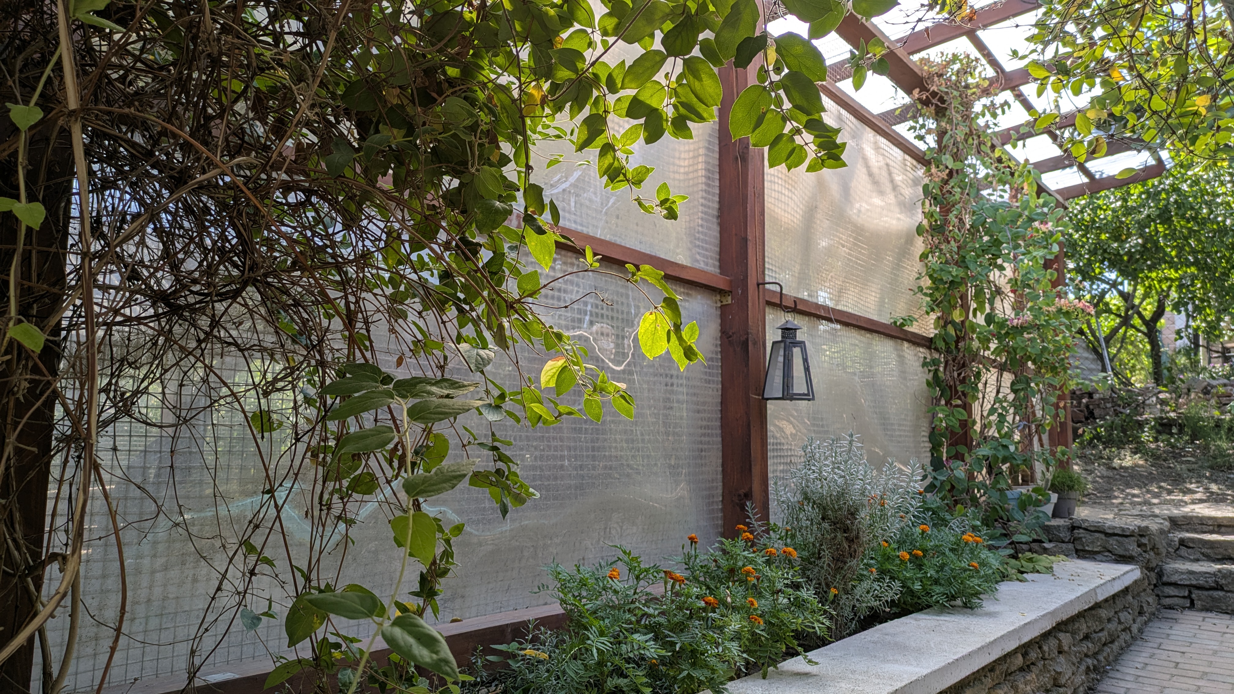

On the northern side, to protect against the wind, I added a layer of transparent PVC foil.

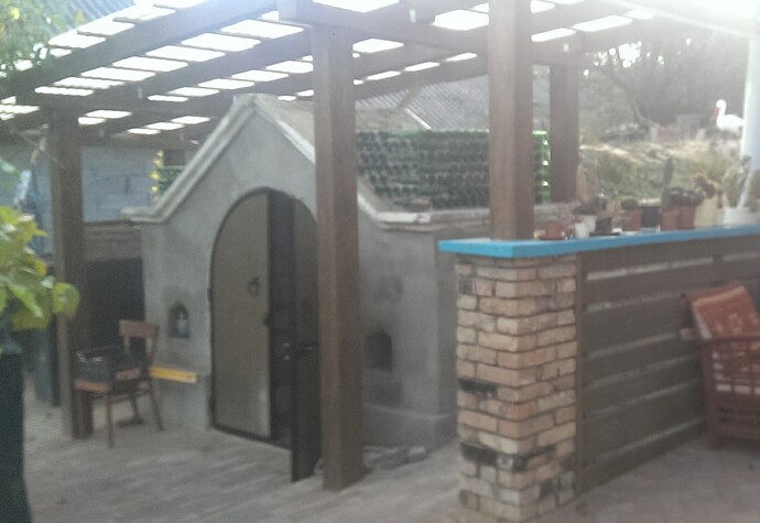

Continuing from the first post..
I was left only with green bottles and decided to fill the empty space between the cellar and the roof with a decorative bottle wall.
This bottle wall is not only decorative but also serves as protection against bad weather, since the cellar is over 100 years old and requires more advanced protection.
Because I only had bottles of a single color left, it was no longer necessary to design a separate arrangement of the bottles, as in the first case. I was a bit doubtful because I didn’t know how the corners between the bottle facades would look, but I was happy with the result, + improved my “bottle-laying” skills :blush:.
All that remains is to add lighting inside, so that the bottles will shine at night.

The biggest drawback is that the bottle corners are fully sealed with concrete, and the interior lighting works well except in the corners.
I really like this bottle look! Even with the sealed corners
