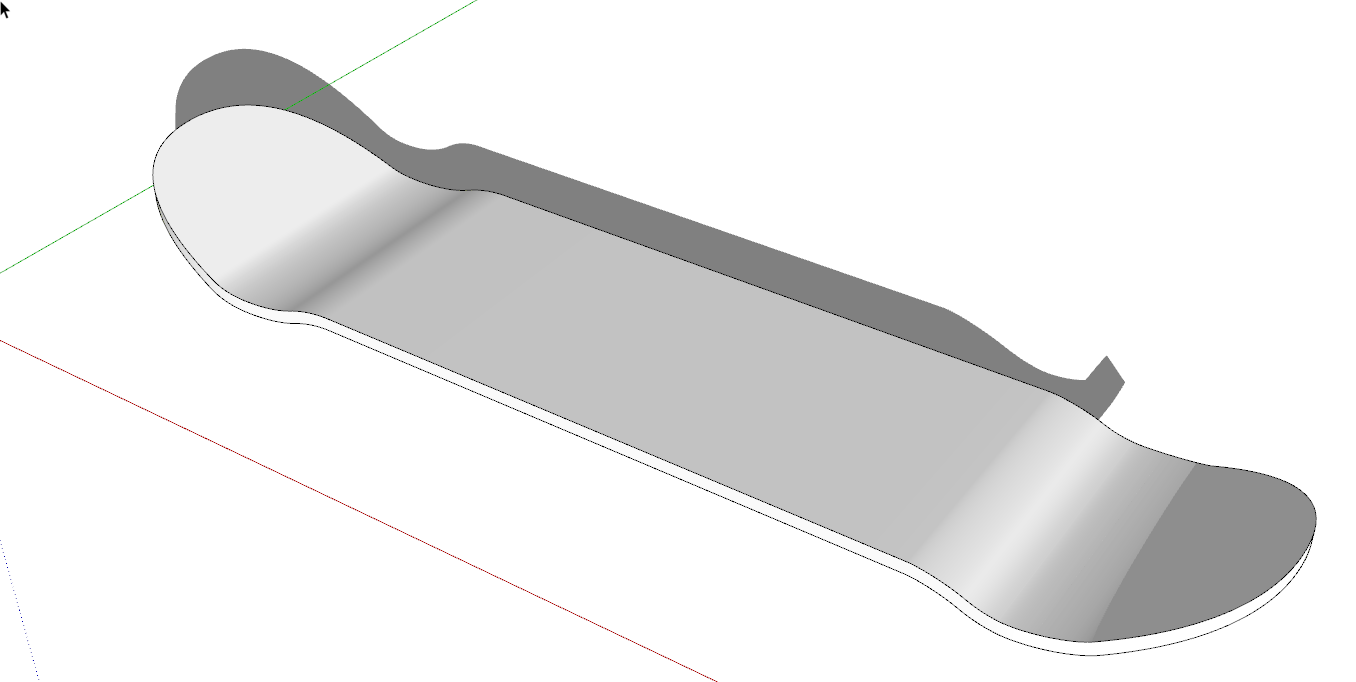

Here’s a quick and dirty skateboard deck as an example. I used several extensions in SketchUp 2020 to do this. It could have been done in SketchUp Shop but not nearly as easily or quickly.
