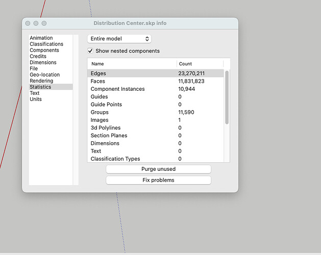

You problem is +35 million polygons. Are you loading things in from the 3D warehouse? How can you simplify your model? Do you have an instructor teaching you how to use SketchUp efficiently? Have you taken our free courses over at: https://learn.sketchup.com/ - that’s the best place to start to avoid overloading (also referred to as ‘bloating’) your model.

The goal is to ask oneself what is the level of detail (LOD) needed? If this is for a Distribution Center class assignment, then do you need to see the screws holding the racks up? This extra geometry adds up yet does not contribute to advancing the concept. I’d recommend getting rid or or re-drawing these kinds of things. It’s good practice to check the poly counts of components in 3D Warehouse and if you can find a rack that has say 2,000 polys, that’s better than the +1 million one.

It is still a mess and I would say many of the issues come from imported obj’s, multiple nesting and over complicated components. As @eric-s mentioned.
But also you model is tiny, I scaled it up to a more realworld size, I used the door frame at 920mm. It is also not near the origin, I moved it there after removing the three strange stray edges.
I also turned off ‘Profiles’ this is a resource suck.
I also deleted the number that was included with each and every bolt in the many many brackets (as shown by eric) 3d text hugely complex.
You also have tag issues but I didn’t address them.
This might be enough for you to continue and complete your assignment, but you desperately need to learn how best to use the software.
