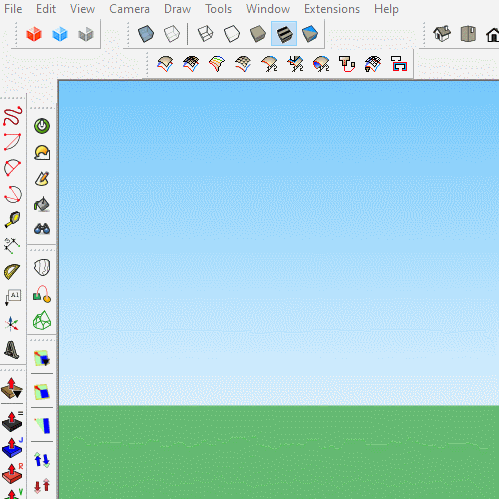

Just to demo what endless is saying.
GIF 26-01-2022 6-37-32 PM
