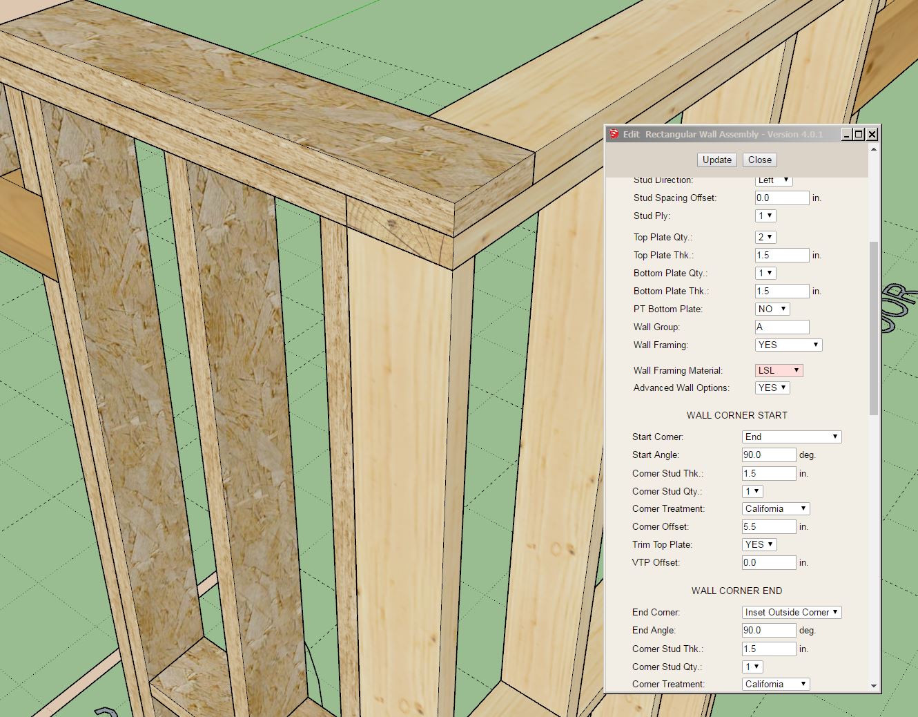

Per customer request I will add in an LSL option for the framing very shortly:
I’m using the updated LSL texture I created for the Floor plugin, but I still feel like it is a bit dull or dark compared to my previous texture (OSB). It could be a bit more vibrant or saturated. I will need to spend some more time on this.
Weyerhaeuser sells their Timberstrand line of LSL framing and studs:
However, I would always worry about water damage. What happens if the LSL gets wet? We all know what happens to OSB, and plywood is a much more robust product in comparison. Standard lumber seems like a much more resilient choice when it comes to potential water damage, but I could be wrong.
The LSL framing members are very different from OSB. The advantage is they are strait!! No Splits no knots. They dont get pulverized from hold downs with a ridiculous nailing pattern. More expensive!
Dimensionally they are more stable, at least that is what they claim (when they remain dry). Unlike standard lumber they don’t twist, split and warp and I suppose shrinkage is also minimal.
