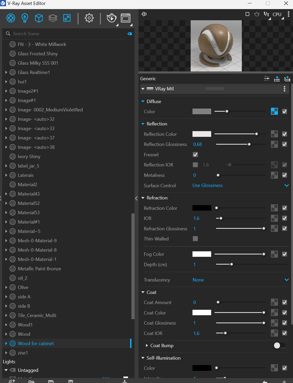

I keep experiencing this issue in vray, where a material will render fine, and then, without changing anything on the material settings, it will start to render in bright turquoise.
I’ve tried remaking the face and reapplying the texture, I’ve tried only using the materials you download from vray, but for some reason, this keeps happening.
I’ve also tried duplicating materials that I know work, and changing the jpg in them. It seems to keep happening with wood textures, which I can’t see how the image in the jpg can have anything to do with it, but it is something I noticed.
