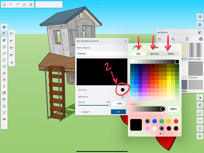

We didn’t add the Colors library to the collections in 3DW because it was debatable as to whether it was more useful than simply creating a new color, using the iOS color picker options.
Too many screens to get to that picker. The same on markup tool. I know how that works is Apple’s responsibility, but I think you did it better on desktop and I have also seen a lot of other apps with greater accessibility to color pickers.
