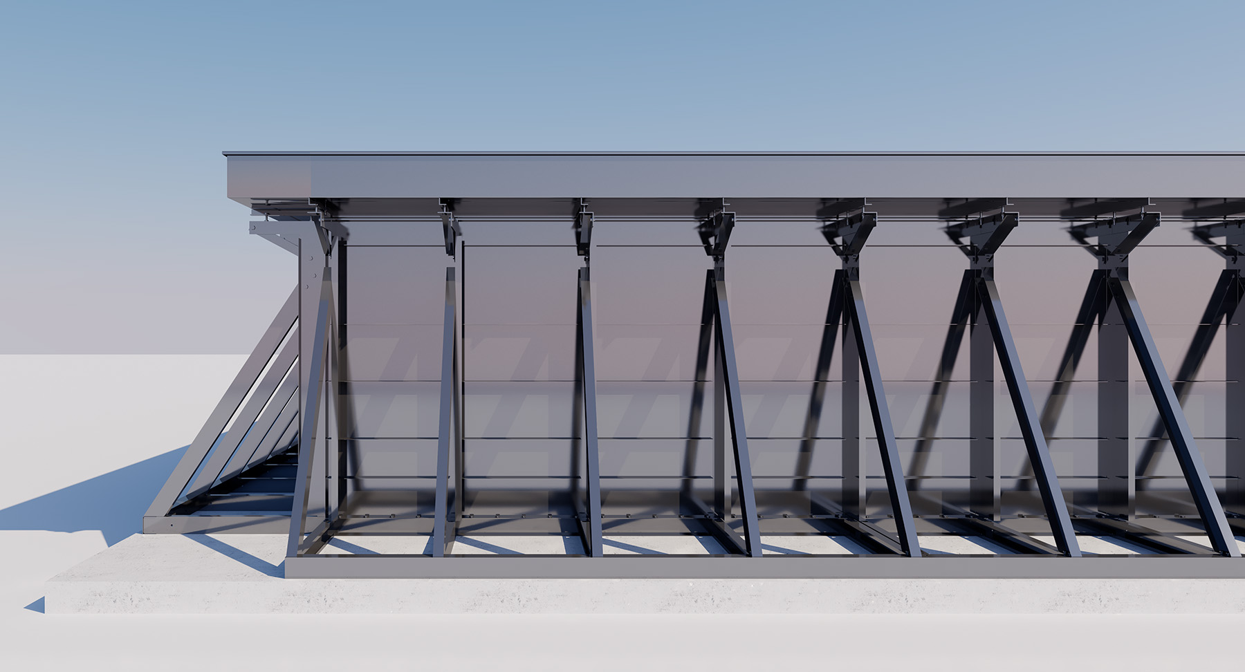

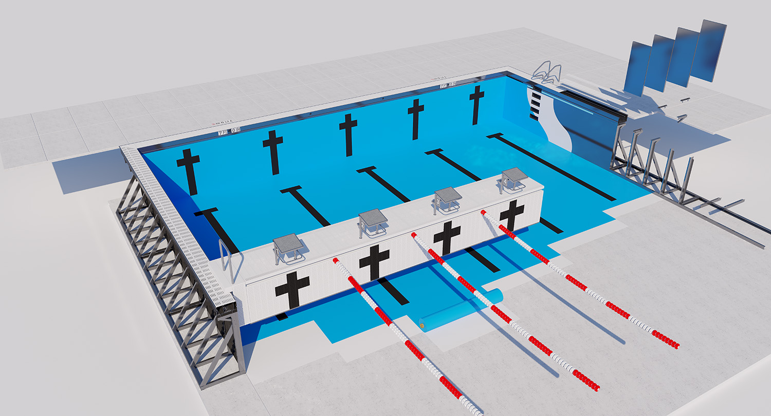

Visualizer was the perfect solution for quick renders with rather simple GUI and transition from SKP to VIZ. I do a lot of concepts with metal and water in the model so being able to have a pretty decent “metal effect” just by naming the material “shiny”, “metal” and variants of color was a breeze.
Twinmotion has great promise and even faster renders, the water effects are almost photo-realistic out of the box…but the weather and daytime / evening settings are whats makes it worth the money (free right now if you hurry). I have not had too many crashes per se, none more than typical when asking the OS or the software to do some pretty intense calculations or renders…but as mentioned the material / color conventions TM wants the user to adopt means I can spend less time in SKP messing with materials and just let TM handle the effects.
The last (2) spa images are what I was getting after using TM for about 2hours…the others are all Visualizer…no post on any of the images…so there is room for improvement in PS.
