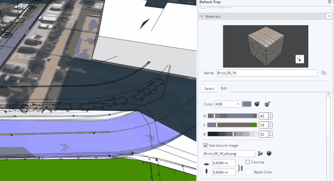

match color of object will get the average value of another texture to edit the one you selected or are creating, so that it matches the one you sample. example :
match
see the difference with match color on screen ?
when picking something on the satellite picture texture, one will pick the exact color you aim the other one will get the average no matter where you click

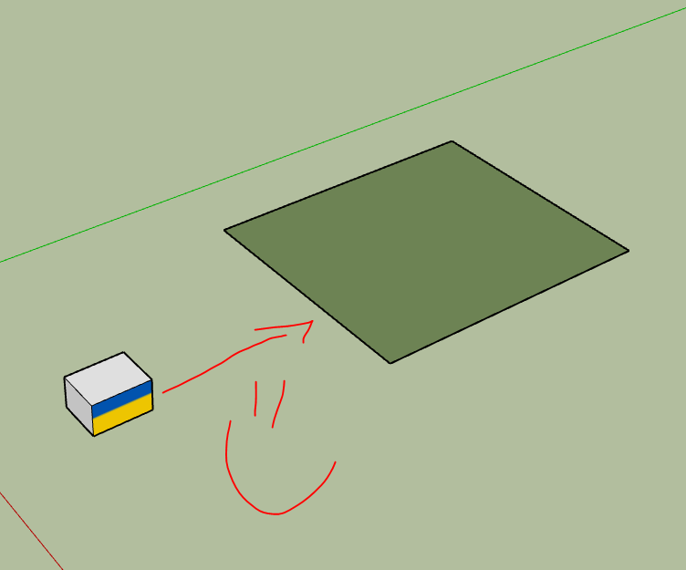

Thank you for helping to understand! OK in terms of color. But what about which object affects which, I can not figure out: e.g. I highlighted red cushion, then I picked the tool, clicked on green cushion, and this action affected not the highlighted cushion, but the cushion with fabric material. Sometimes I pick the tool and nothing happens.
What is the sequence? :slight_smile:
highlighting/selecting an object will not load its texture. Press B to invoke the bucket tool, press alt to bring the sample tool and pick the color you want to edit. Then and only then go to the edit tab in your material panel and use the tool.
don’t see the tool for matching as a way of inheriting texture properties from an another one (like match properties in autocad, for example), if you want your red object to have the same texture than another one, load it like explained above, and use bucket tool while editing the object/component
