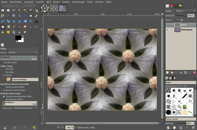

Gimp is free, and handles the process pretty well for most of what I work with.
