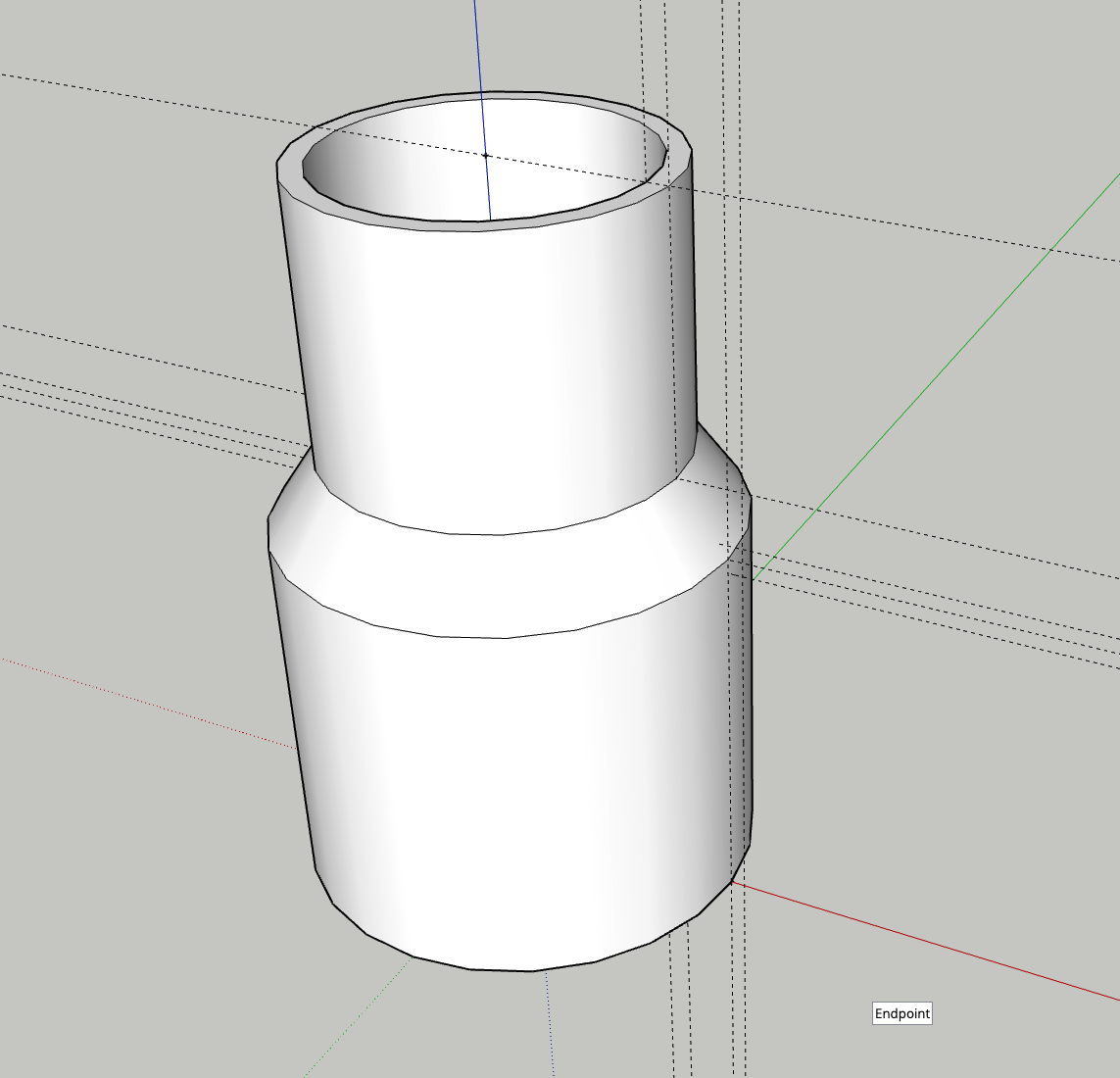

Thank you so much for the guidance. Here is what I came up with. Is there any way to more reduce the flat planes that translate into the slicer? A smoother exterior?
And this is it in the slicer
Yes. You can do that by using a larger number of sides in the circle you draw for the path. Modeling in meters allows that because it avoids the tiny face issue. I find that 96 sides is usually plenty for most 3D printed stuff and I almost always use some multiple of 12.

Dave, You are the reason I love the internet. Thanks so much for your help. Endless search has resulted in lots of comments and people suggesting other programs and other ideas when this way just works. Thanks again now to get my dust collector hooked up. I could pick you brain all day about modeling screws on sketchup as well something I have not done. Model image attached at 96 sides. Now I will print and see. Thanks again for picking up a 3 year old post so quickly.
