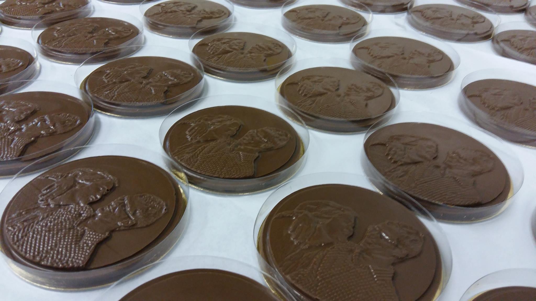

and this has to be the result:
So i have to create the coin print it in 3d. After the 3d print i’ll make a mold for chocolate.
