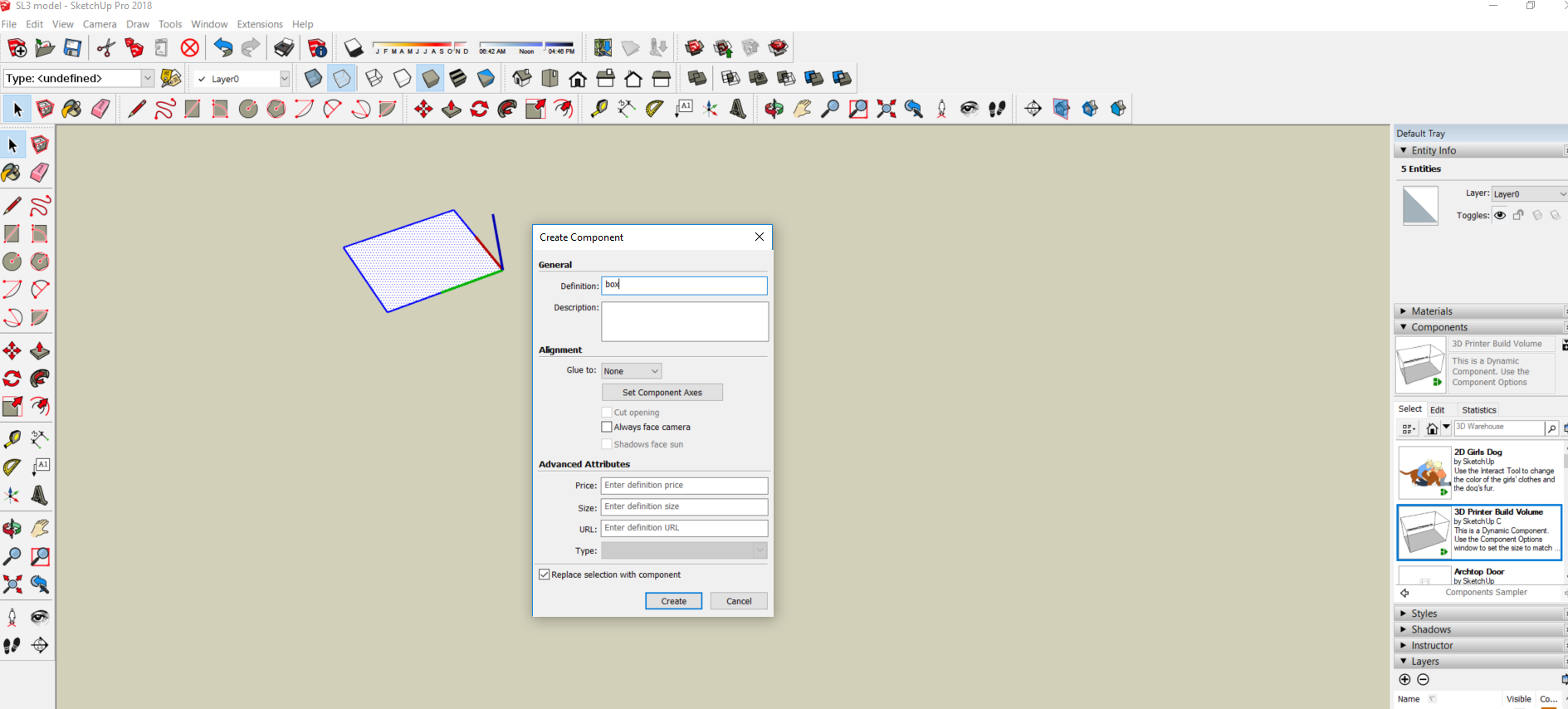

"make component" takes very long, does not complete - too long to be productive
Using sketchup pro 2019 on windows. File size is large 125gb. Don’t blame problems on hardware…
How or what do I need to do to make this function take less time?

How long is it taking SketchUp to generate the component?
If you close down the component browser and Outliner window, is it faster?
Your graphic shows that the example in 2018. Are you seeing a speed degradation in 2019 vs 2018?

haven’t been able to in this model … way to long.
file take ~7min to initially load and roughly the same time to save… so auto save is turned off.

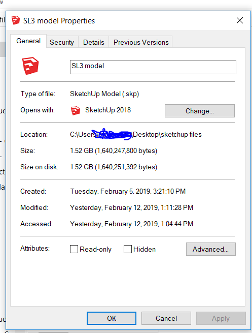

15 million edges and 8 million faces is a large-ish number but not “crazy large.” Note that the size displayed in the Windows dialog box shows about 1.5GB, not the 125GB stated in the original post (as of this writing). 13 thousand component definitions is a pretty large number. Have you been able to try @ChrisDizon’s suggestion of closing the component browser and outliner windows (if they are open to begin with)?
For reference, the largest model file that I occasionally work with (using SketchUp Pro 2016) has about 3 million edges and one million faces (in about 1000 component definitions), and consumes about 280MB on disk. Loading it takes perhaps a minute. Saving takes perhaps also a minute or so, but I haven’t tried in a while; I generally work on sub-sets of the overall model saved in separate files.
