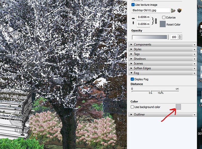

Did you try going to Window>Default tray and turning on Fog?
Screenshot - 3_23_2022 , 4_17_40 PM
The colour popup menu, which is found by clicking on the colour swatch (red arrow).
After making sure the “use background colour” is unclicked.

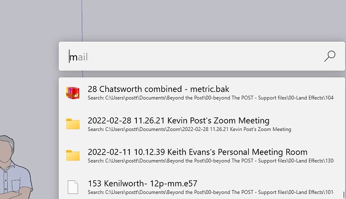

The alt-spacebar, m, any arrow key, move cursor, does work with the fog color panel in Windows 11. The steps are exact though, and is assuming you’re running in English.
I have tried that alt+space m arrow key and this is what I get:
I found the issue, I am running PowerToys on my machine. I turned it off and then the alt+space m arrow works!
