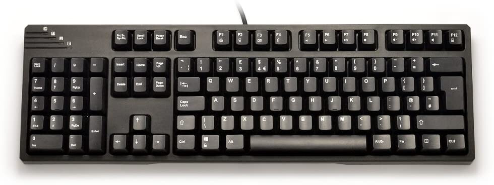

I have to release the mouse or using the left hand that is on the left side of the keyboard.
I don’t understand programming but it feels like something simple to add to the list tools we can create shortcuts for. (sorry if I am completly wrong.)
I also though about getting a southpaw keyboard to have numbers and arrows on the left side but feels
like its something that should be possible to solve on sketchup itself.

I really think that the best solution for this would be a left handed keyboard like I have said before.
The problem with that is not only that is very difficult and expensive to get one but also that means me not being able to go to another computer and work with the same level of productivity/comfort.
If it was possible to work around this with an extension or a native shortcut would be easier.

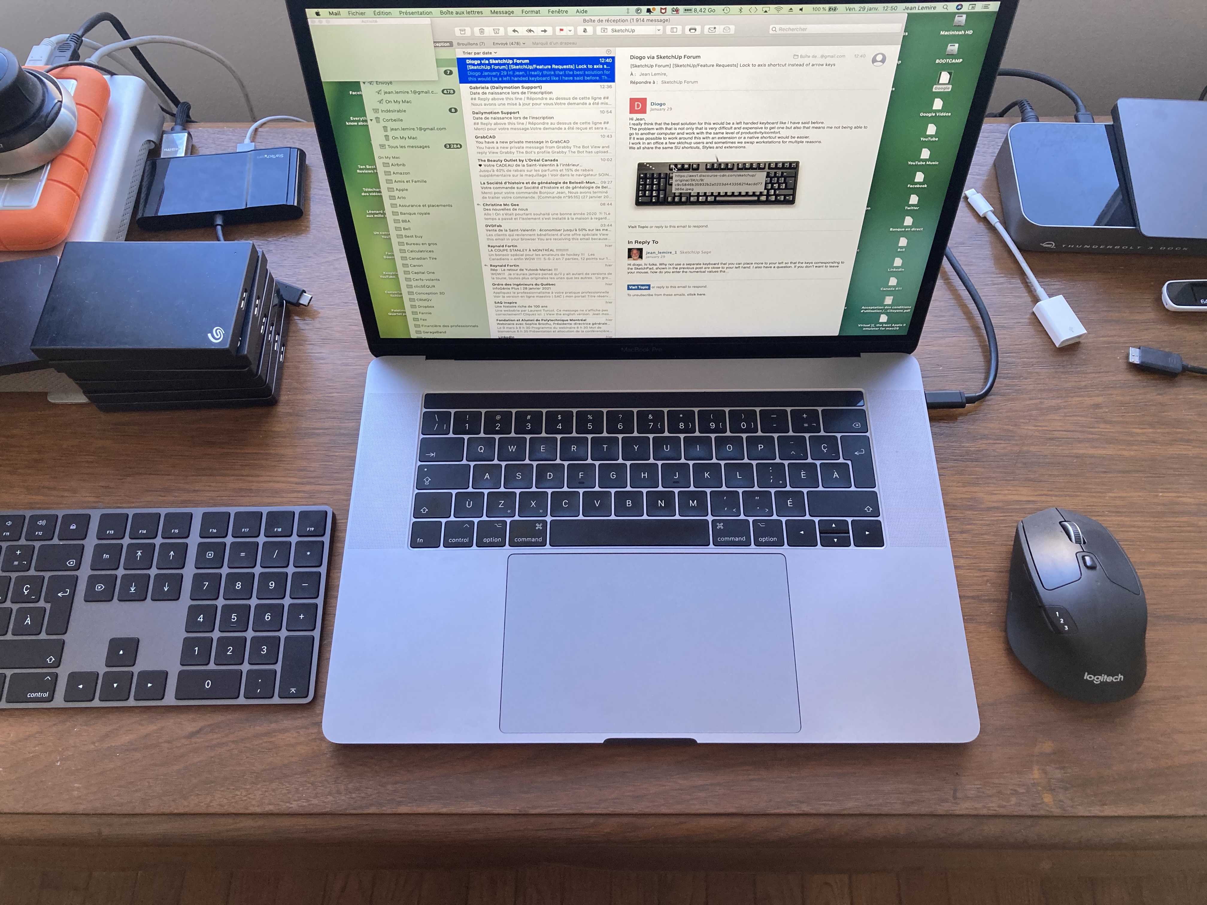

Hi Diogo, hi folks
This is what I had in mind, see attached image.
That way, I can use the rightmost keys of my Magic keyboard (bluetooth) for arrow keys, numerical keypad, etc. and then the computer keyboard for text, etc. Note that this could be any USB keyboard.
