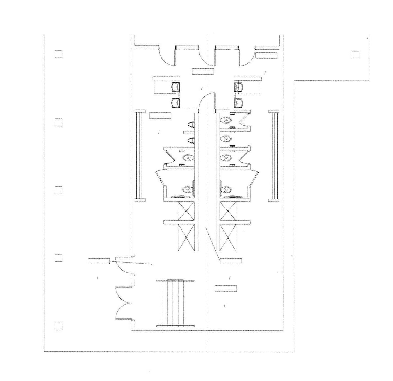

I have been using Sketchup since Version 4 and I have never had this problem. I understand that certain blocks and text cannot be imported into Sketchup from AutoCAD, but here lately even basic lines are not coming in. I am using Sketchup Pro 2018 and AutoCAD 2018. Any thoughts??

See the issue with the South and East walls
Does this file have any AutoCAD Arch walls in it?
all walls are simple lines.

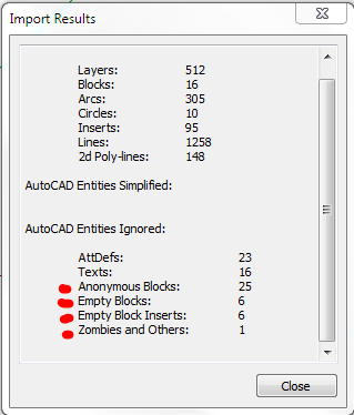

Edit: There were 512 layers in that drawing. I did a purge command and got it down to 49. I guess the OP should start cleaning up a drawing before bringing it into SU. Something I always do.

A good rule to follow is to export larger CAD files in smaller pieces – to help remove unwanted layers, styles, settings, blocks etc. Try ‘LAYISO’ for just the wall layer(s)…Then select all and ‘WBLOCK’ to write just the walls. Position remains in tact so should import right in place with your previous (missing pieces) import.
See attached screenshot of first try importing wall layer from Wblock.
