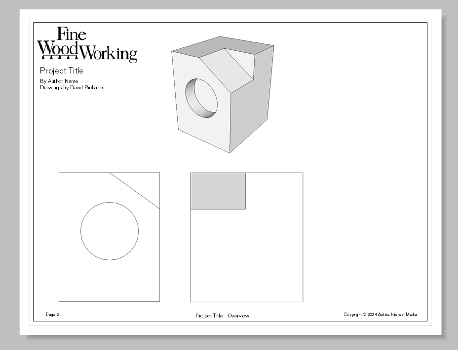

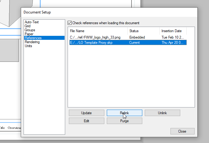

First create a proxy SketchUP model file with the scenes you will have in your project files. Make this your default SketchUp template in which you’ll create your SketchUp models. Send that to LayOut and select your custom template. Set up the viewports as desired on the different pages and save that as your LayOut template. When you are ready to start a new LayOut file, open your custom template, go to File>Document Setup>References, select the .skp reference, choose Relink and select your project file. Here’s an example from a template I have for one of my clients.
The first sheet of the template looks like this with three viewports.
After selecting the reference in the list, choosing Relink, and selecting the project file …

I get the three views of the project model.
