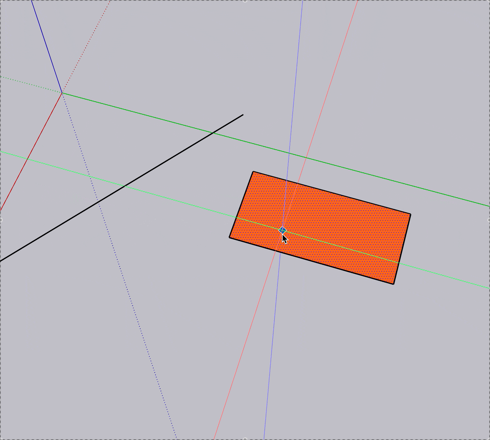

I don’t want a Layout move tool that acts the same as SketchUp – in your specific example – in that if you were to hover over the vertex you’d click and then move the vertex.
Because then you would need to have a collection of geometry that currently forms a connected shape be a group to avoid having to select all the geometry the move the shape geometry on masse.
And then if you need to have a shape as a group, you would then need to double-click into it – like you do in SketchUp – to then manipulate the vertices.
But wait a minute, that’s just like it currently is – to manipulate the nodes of a shape in Layout you have to double-click the shape to access the vector edit mode.
Your specific example Odd – I’d say – is one of inferencing.
Enough of this: Layout must be like SketchUp so we can use it effectively because currently we can’t.
As I said – I’m all for improvements that work in the context of what Layout is but not necessarily to emulate SketchUp or some other software.
The one thing I regularly reach for is Guide Lines in SU. If there are any improvements in LO 2025 this would be very close to the top of my list. In Odd’s example it would remove some of the inference uncertainties e.g. what may appear to be aligned or correctly connecting isn’t always true. I don’t trust the inferencing. Under close scrutiny I regularly see points jump from the what was expected because Grid Snap is active, there is a last nano second shift to another close point or the inference just wanders off along a line rather than prioritising the expected intersection.
I would say that the inferencing in 2024 is very much better than it has been – as per my examples.
The example Odd shows is the experience that I too would experience prior to 2024.

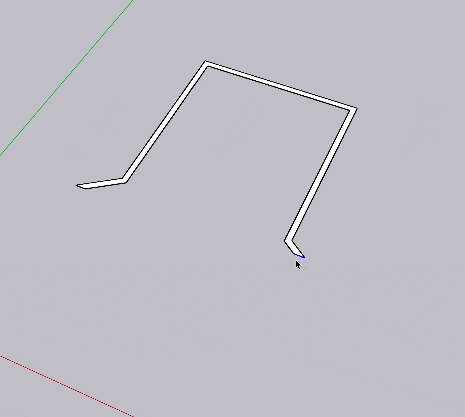

well that works. Thanks. I would want inferencing to work on the line itself, not just from hovering over a parallell line, though. And sometimes it does. Like when I extend the second line. I dont always get snapping to the meeting line to actually snap, though, as one can see when I zoom in at the end.
Screen Recording 2024-11-16 at 10.52.41
In my second extending lines It seems Layout now remembers this direction from the last inferencing, so I dont have to lock it.
In this second example when I try to move more than one vertex it certainly would be useful to get inference locking from an existing line upfront, like in sketchup, as all lines moves together so the trick from above does not work. In this instance ordinary linework passing as guides does the trick though, after a litte fiddling.
Screen Recording 2024-11-16 at 18.38.35
So a little more SU logic would certainly be cool here, I guess.

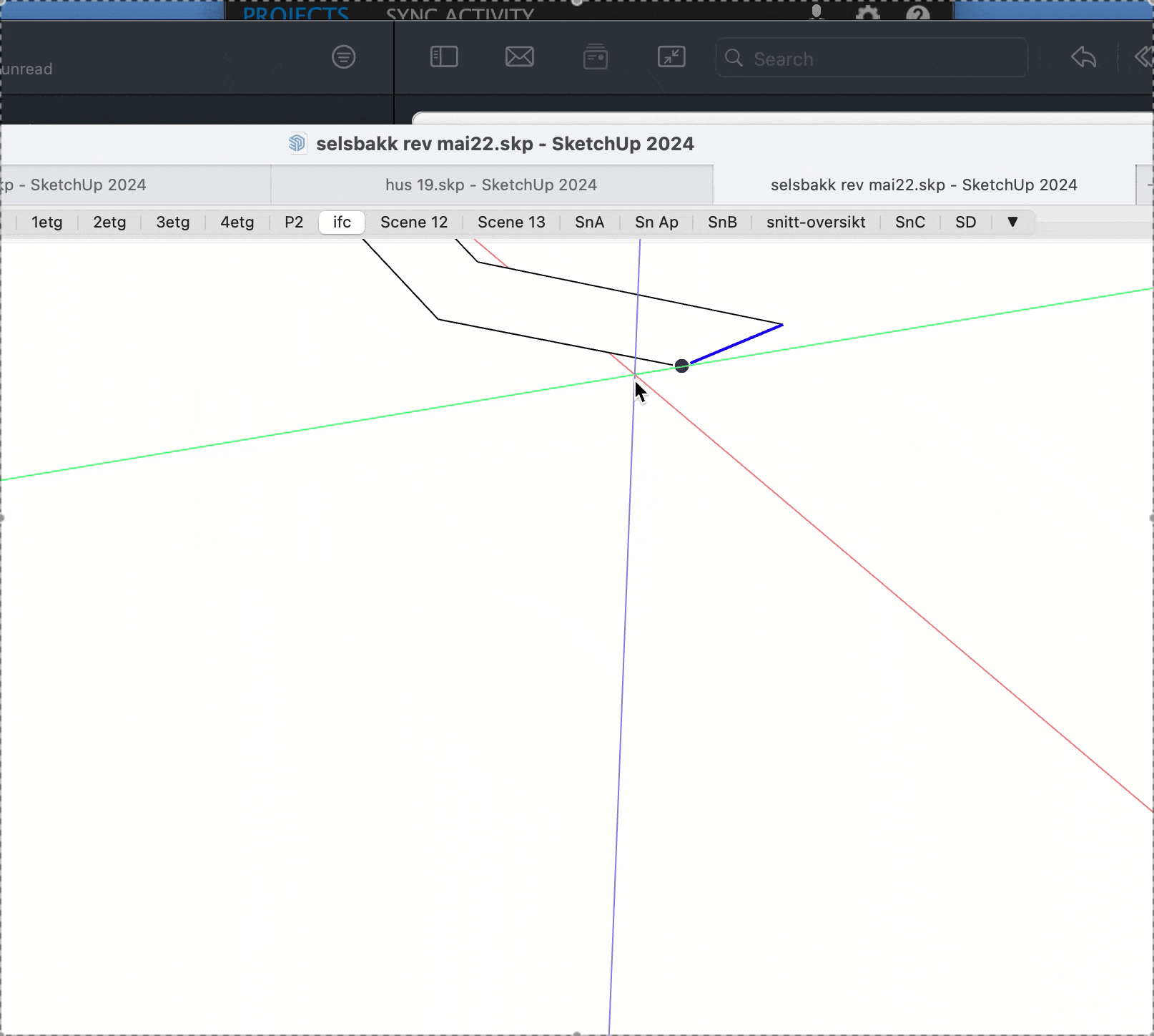

hover over line, press shift to lock direction, move tool 2 clicks
Screen Recording 2024-11-17 at 01.45.02
hover over line, press shift to lock direction, move tool 2 clicks, last click is on the line one refers to (not midpoint snap or endpoint snap, but “constrained on line intersect line”)

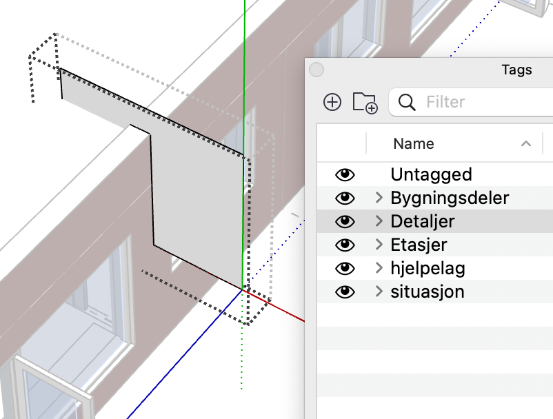

yes, the easiest way to draw 2D in sketchup is probably to keep it in a group, Inplace where the detail is supposed to go, so, that you can reference sizes in main geometry, and then have that group containing tags in a Tag-folder used for details. You can have specific scenes for the details, and can easily have it separated from the main model. That main model has scenes where the details folder is hidden.
But the principles of inference locking works also on geometry that are not" well placed" related to the axis system
