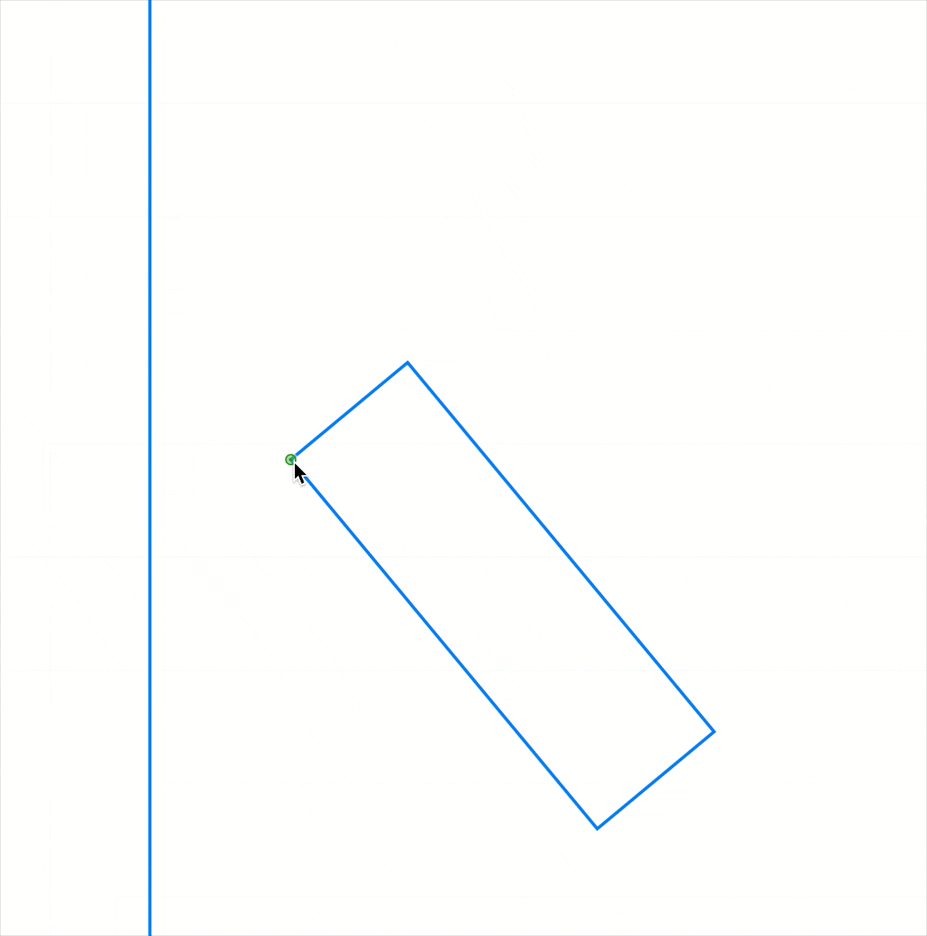

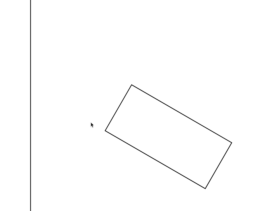

here I repeat a task I tried the other day, to extend the vertices in a rectangle until it meets a line. Must admit I ALWAYS avoid drawing things in Layout, but still I went ahead with some Sketchup thinking, some reference locking, so just move each vertices, with direction locked. That does not work at all.
Screen Recording 2024-11-16 at 00.04.44
I then come to my senses, and try to instead make new extending lines, that works a bit better, but still, strange inferences all over the place.
Screen Recording 2024-11-16 at 00.01.38
I guess the right approach would have been to not try to alter the existing geometry, but rather draw new geometry and delete the old.
That they just will not leverage the drawing concepts of sketchup is really something I dont understand. And all this is I guess because they will not make the move tool, because doubleclicking into the geometry (Why is that needed) then hovering over a line means “Move”, so then you cannot have inference locking.

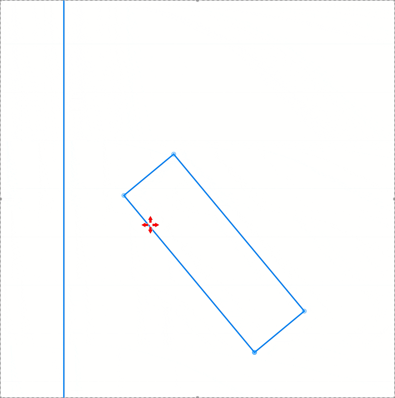

To be fair I did find a way:
Screen Recording 2024-11-16 at 00.59.08
but thats just it, no leverage of sketchup knowledge, and planning for every single move, instead of the sketchup way where there’s many ways to the same goal.

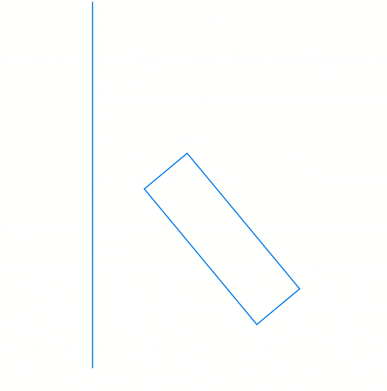

Odd…
Layout24_inferencing
This is in Layout 2024 – hit the down arrow key to get the magenta inference.
And…
Layout24_inferencing_02
