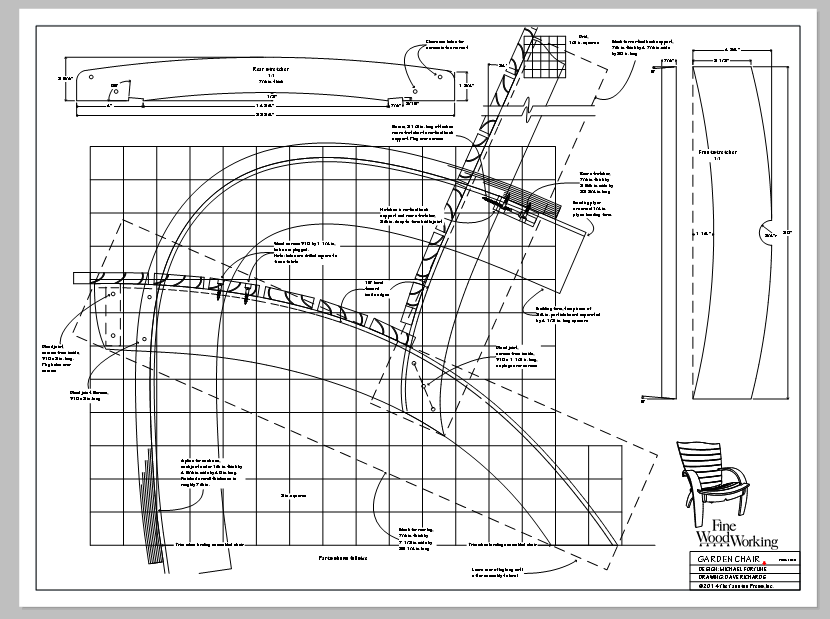

There are a lot of ways to use stacked viewports (what @tpdes describes) in LO. My suggestion is to put each viewport in the stack on a different layer. It makes it easier to get at each one when you need to do it.
There are nine viewports stacked in the main view for this chair plan. Each is on its own layer.
So far this is too much hard for me :wink: hehe.
Keep practicing and you’ll be able to draw things like this chair, too.
Drawing that chair is easier than building it. :slight_smile:
I haven’t built one out of wood yet but a lot of people have built them from the plans I created.
