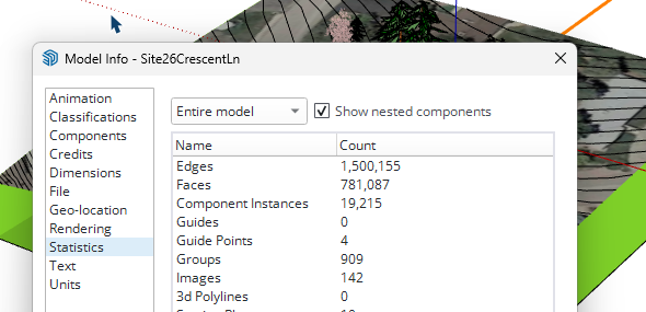

I have your files and. I can see why LayOut would be slow to update the reference. For one thing you have more than a million and a half edges which LO has to render or at least consider for rendering for any vector- or hybrid-rendered viewports.

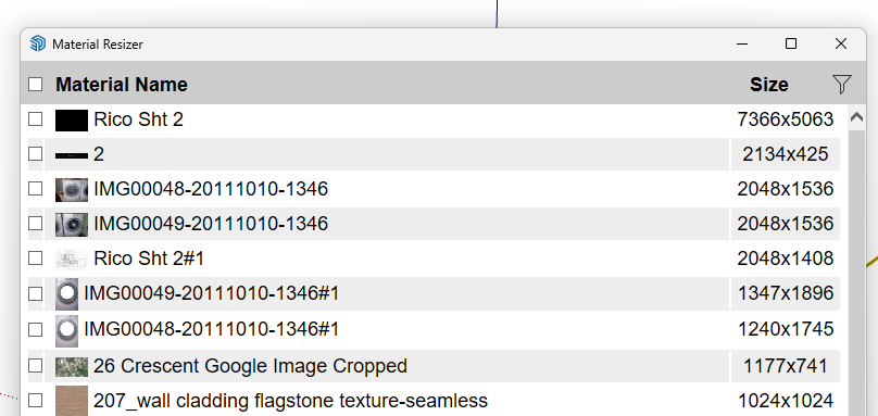

In addition, there are a number of excessively large texture images. Since the textures get downsampled anyway, there’s really no point in them being so large but they do require more resources to process.

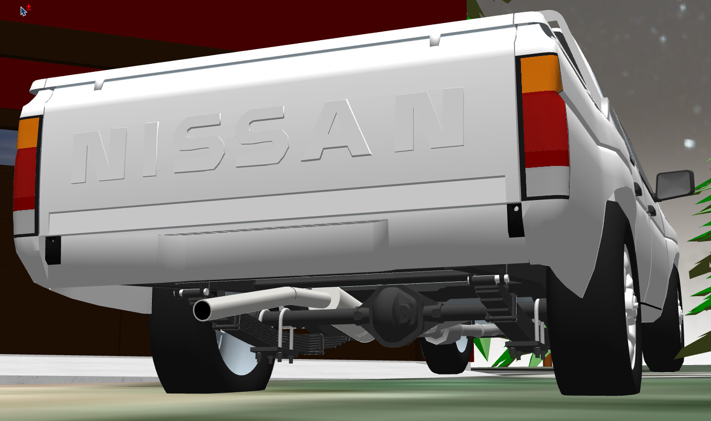

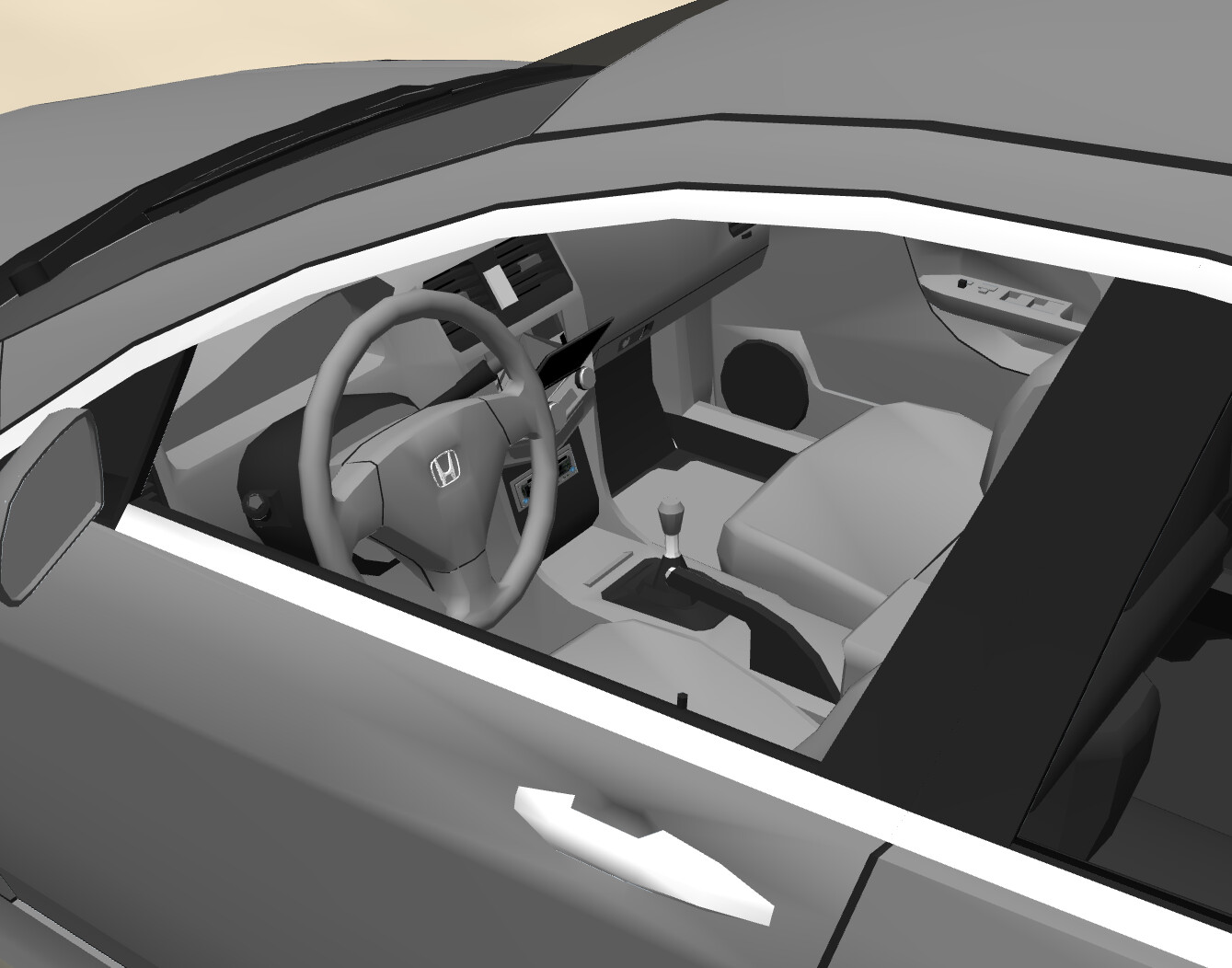

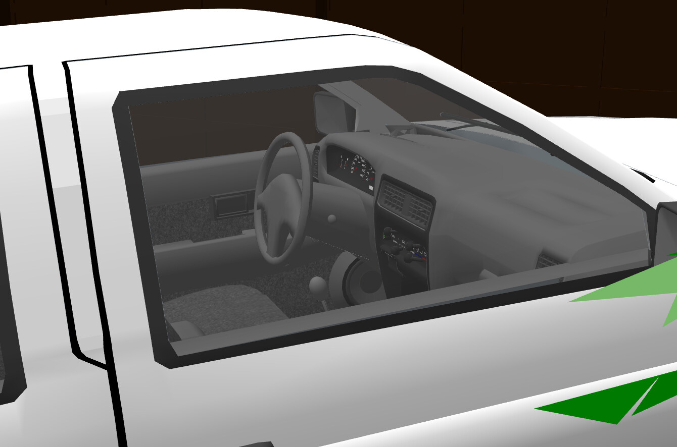

You could simplify the model a great deal by doing a little surgery on the vehicles. Do you really need the undercarriage detail on the pickup truck. Do you need its interior? Same with the Honda sedan.
Eliminating that kind of unneeded detail would reduce the entity counts and the materials which will improve performance in both SketchUp and LayOut.
