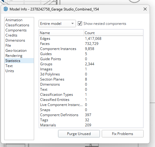

Define “simple”. Define “a few”. See what the ModelInfo>Statistics window says when the “Show nested components” box is ticked. If the edge/face count is in the millions, there is no way you can use Vector or Hybrid rendering in LayOut. If you absolutely need that kind of output, keep your viewports at Raster and use the Output Override, and wait.

OK. Looking at your SketchUp and LayOut files now. All the viewports are rendered as Raster which should improve speed. It’ll also show the sketchy edges style you’ve selected. Are you seeing a slowdown with the viewports rendered as Raster or is it when you switch to Vector or Hybrid? I see the model has a large number of edges.which would impact render times for Vector and Hybrid.
Although it wouldn’t have anything to do with rendering/update times in LayOut, I fixed incorrect tag usage. Not too bad compared to many I see but you should stay on top of that.

I updated the reference in your LO file after doing some cleanup and all of the viewports rendered in about 10 seconds. This is on a PC with an Nvidia graphics card. It’s possible that some of the slow down is related to your hardware.

I’m glad to hear it’s performing better. I ran CleanUp3 on your model a few times. It merged a lot of faces and removed coplanar edges. It also merged some materials.
