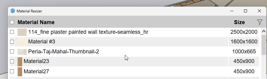

Of the remaining materials there are a few that are larger than they need to be for what they do.
