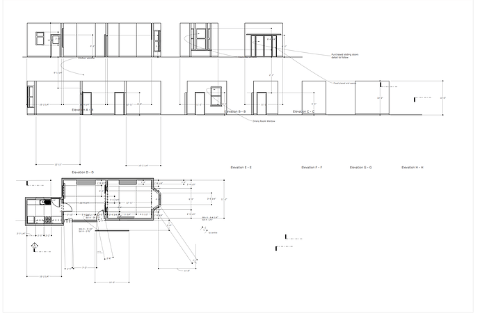

I’m working in 2d.
Having drawn up my plan in sketchup and then sending to Layout, in order to add dimensions. I then want to amend the drawing; so go back to sketchup, make any amendments - then switch back to Layout and then render model on page in order to see the new changes made in sketchup
This then stretches all the dimension lines and the model moves.
I’ve attached an image to show the results (won’t let me add two images so can’t show the before image)
Can anyone advise why this is happening & how to fix it ?
Thanks Andrea
Reading this on my phone it’s hard to see where the stretching is. I have done 2d work like this just in layout. If you can upload the model can have a look though someone will have the answer.
