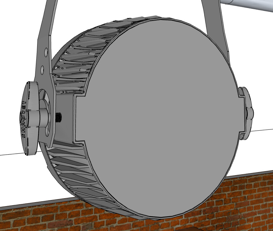

I can imagine your computer struggling with this model due to the excessive amount of geometry. A couple of examples from one of the lights:
Do the holes in the back plate add anything useful to “story” of your SketchUp model and the LayOut project?
What about the details on the knobs? Do you really need the incomplete screw threads? You aren’t using the models of these lights for manufacturing drawings are you?
All of that stuff requires your computer to work harder when rendering viewports. Simplifying those overweight objects will help.

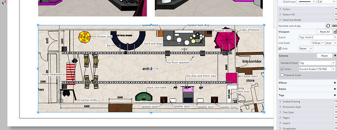

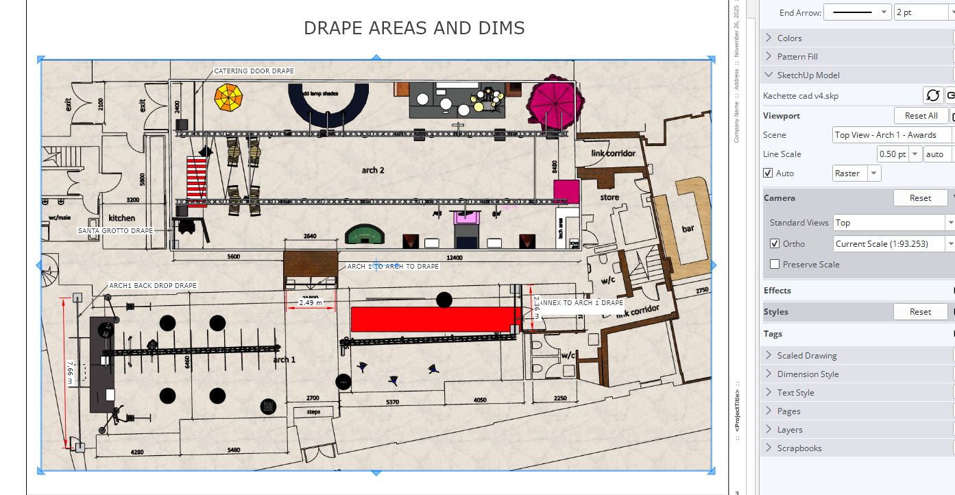

FWIW, I see you have a number of viewports in which you’ve overridden the Camera properties which makes your LO file rather unstable and likely to create more work for you.
If something happens to reset the Camera properties those viewports become a mess.
There shouldn’t be any need to modify the camera properties for any of the viewports in your LO project.
Edit: Out of curiosity, I edited the back plate on that light component. I discovered there are two instances of the back plate in each light so I deleted one and then removed all of the holes from the other instance.The entity count for just the back plate was reduced from 34,248 to 357. That’s edges and faces and a 99.89% reduction.
You could do similar with the rest the lights and other objects in the model which would make your model easier to work with and faster for LayOut to deal with during updates.

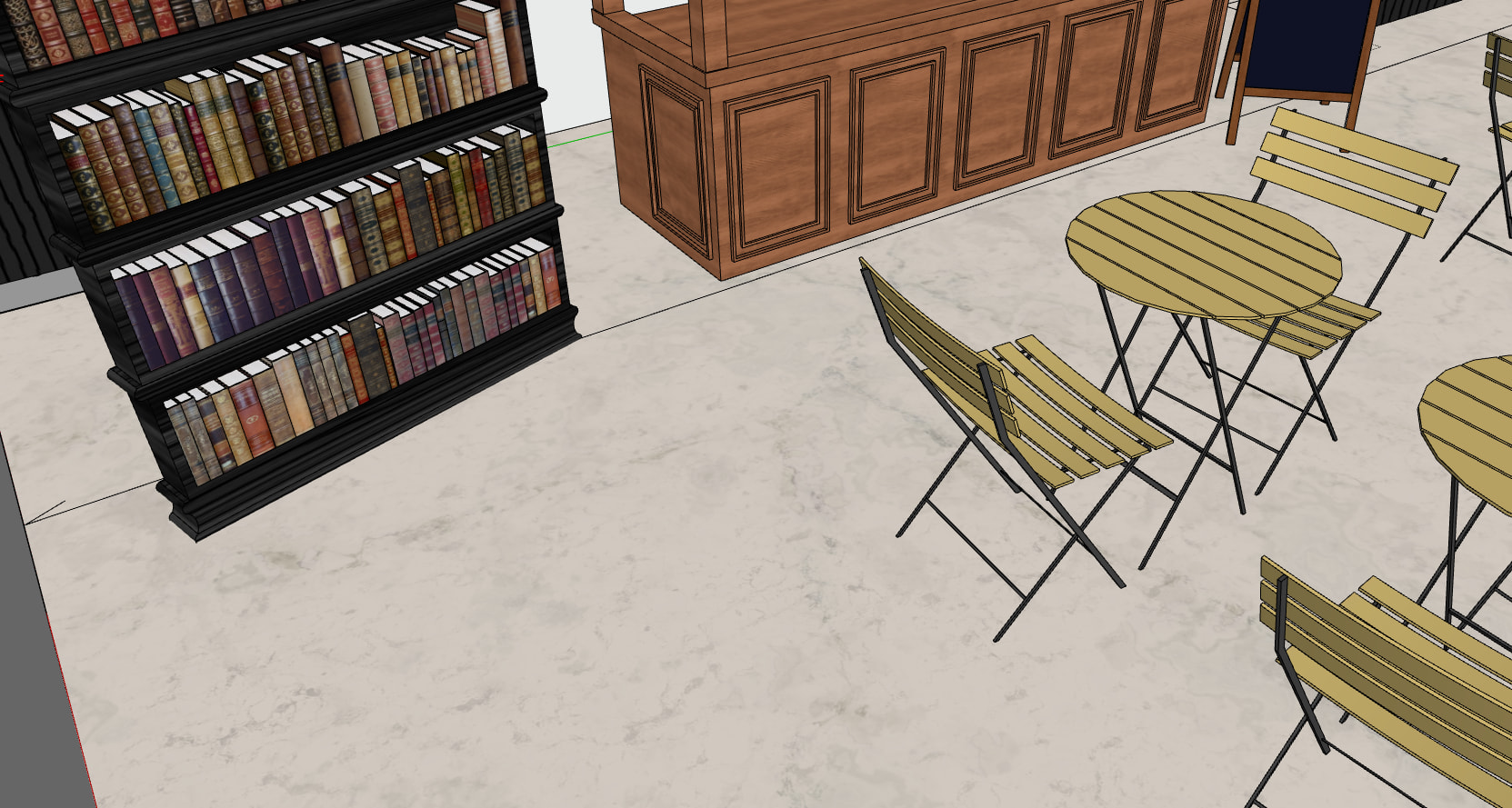

Good deal. I expect you can appreciate this. Think of your model as a stage set. Most of the time you don’t need fine details because they can’t be seen by the audience. Every little bit of detail has a “cost” but it’s wasted investment if it doesn’t advance the “story”. The details on the lights are a great example of no return on your investment. On the other hand, the levitating drum kit is pretty good. Fairly low-poly objects but it tells its part of the story clearly.

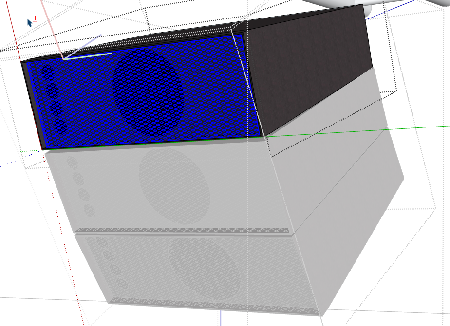

The same applies to the speakers. Using images as materials on flat faces does the job perfectly with little investment.
The little cafe tables and chairs are similarly light weight. I would probably get rid of the texture for the page edges on the books in the bookcase, though. Can’t see that texture unless you zoom in close on the books but that is a texture that LayOut has to conside for rendering if the bookcase is in view in the viewport.
Not to beat the proverbial dead horse but the grilles on the hanging speakers are another killer.
You can’t see them anyway so they aren’t a benefit, only a liability.

Yes.Best practice is to create scenes in SketchUp for each view that you need in LayOut. Then, instead of double clicking into the viewports, simply select the desired scene in the Scenes dropdown. Although it might sound like it’s more time consuming to create the scenes in the model, if anything happens to reset the camera in the viewports, you will be spending a lot more time fixing things, especially if you have dimensions and labels anchored to the model.

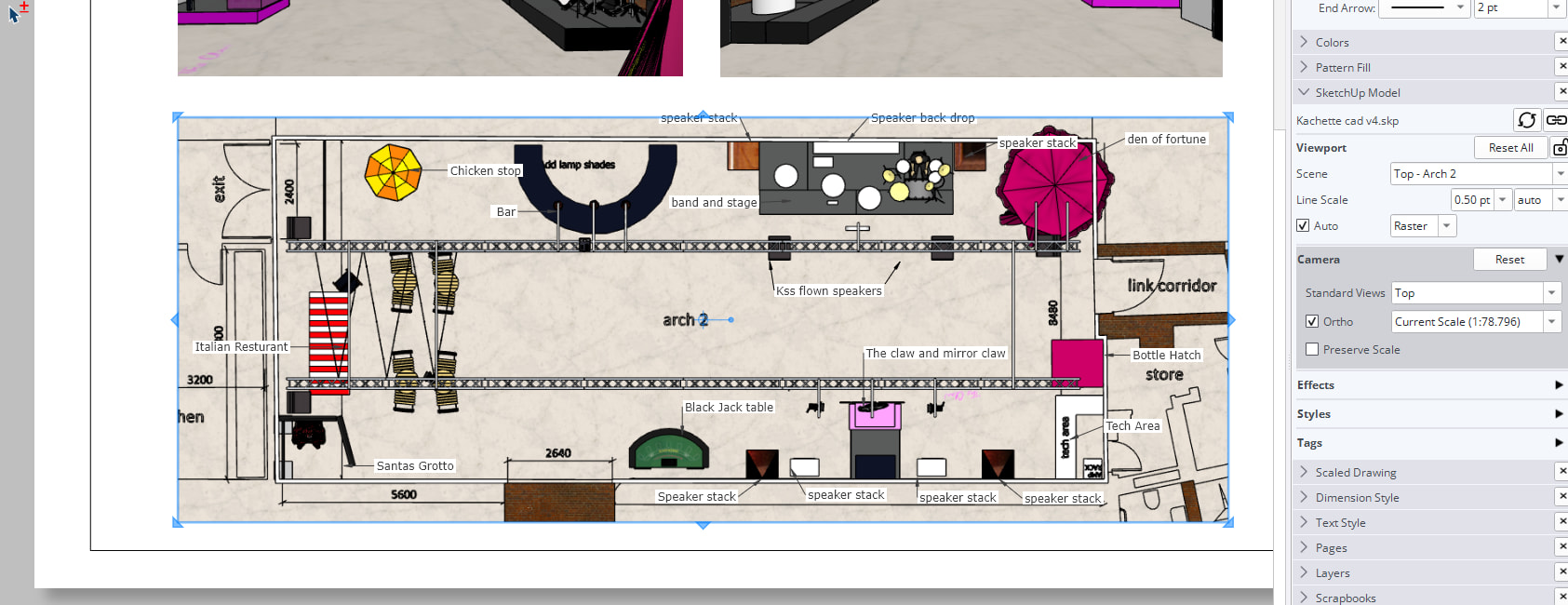

More examples.
Before
After reset.
Before:
After reset:
There will be no problems and no mess if you make it a practice to leave the Camera properties as those in the scene. It’s all about making things predictable, thinking ahead, and making less work in the long haul. In Preferences you can disable the double click to open the viewports, which I would recommend.
