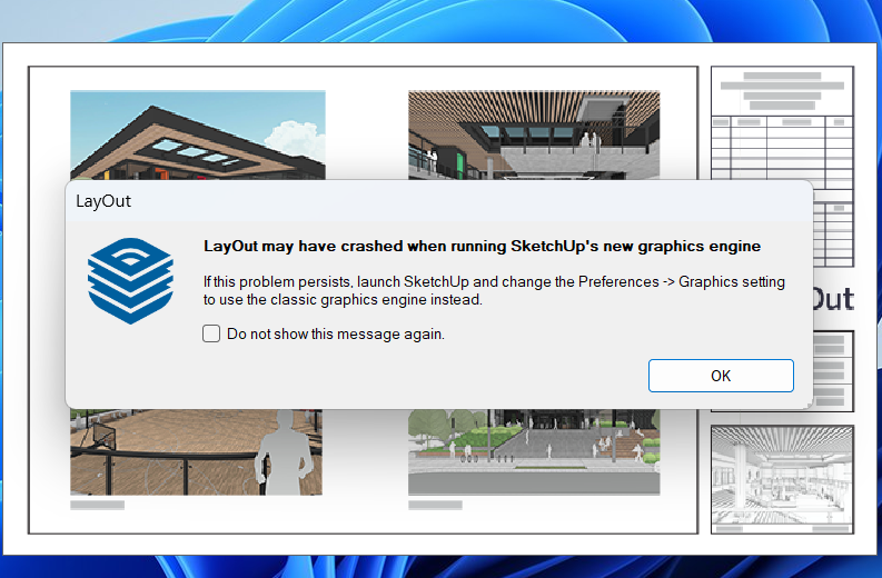

Why layout can’t read my camera views and when i try to update my model Reference layout crashes, can anyone help me please?

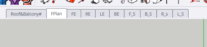

That’s the camera views in SU compared to layout views
I suggest to change my graphic engine to classic and see if it’ll work well.
nothing works still crashing I can’t access anything on layout.
Don’t select Standard Views from the drop down list in the Camera section of the SketchUp Model panel. Set up scenes in the SketchUp model for the views you need and select the appropriate scene in the Scenes dropdown instead.
I get exactly what you mean, and that’s what I did exactly but layout is not updating the name, at the end it crash

That message indicates that your graphics card and the experimental graphics engine aren’t playing nicely together. Did you try switching to the Classic graphics engine? My comments apply with either engine.
Yes I turn it to classic
