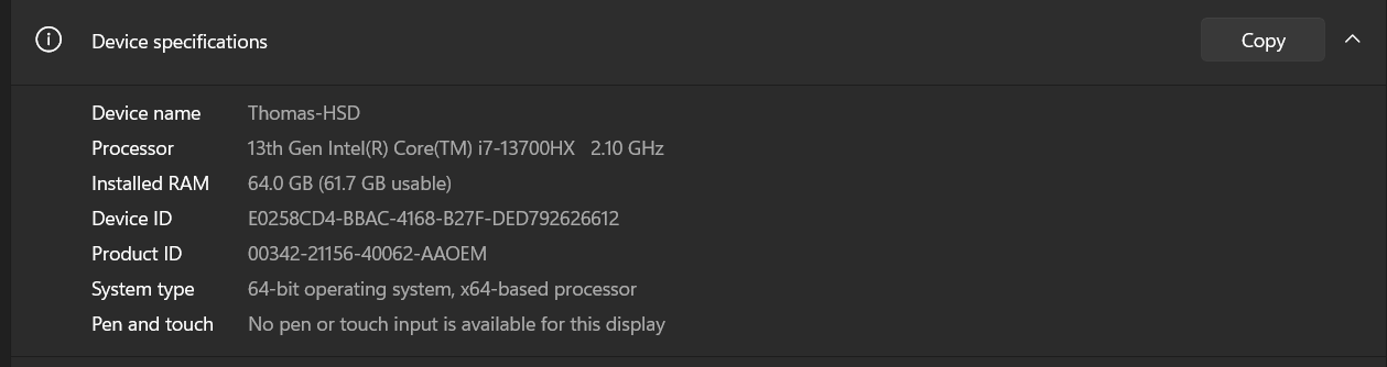

Okay this is obviously some graphics card stuff. I’ll update drivers and test it after. Thanks for looking at it guys. Recently purchased pc
Drivers update and turning experimental graphics back on fixed it completely.
