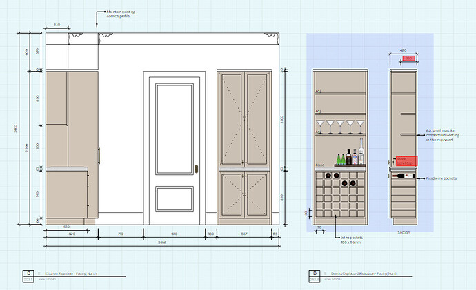

I have tried unchecking the Hybrid output override box, changing viewports between raster/hybrid and turning jpeg compression on/off. It may be a style related issue but I am not sure. Nothing seems to have a direct impact on whether or not these colored boxes appear. I have exported several times, and the colored boxes appear in different areas as different colors and sometimes, don’t appear at all on certain viewports. Is this a known issue with a quick fix? Any help is appreciated!

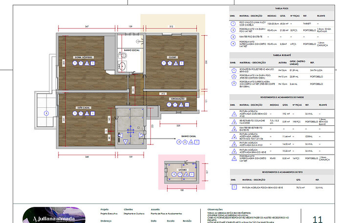

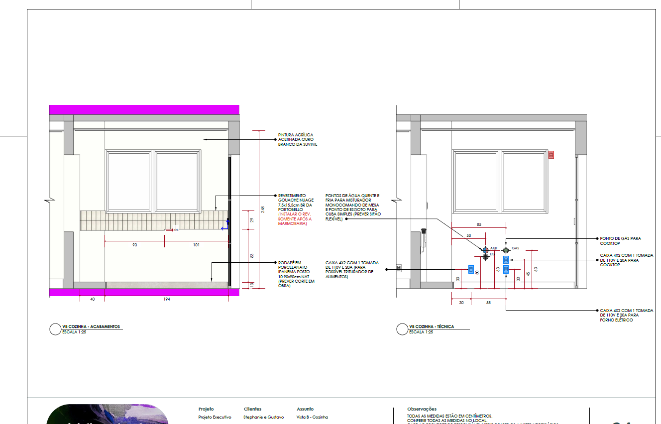

I’m also getting the same issue, this is also happening in the viewports which also translates to the printed file. When I move the viewport box the coloured boxes sometimes disappear or change colour. Anyone know what is going on?
I’m also having the same problem… Some of the viewports in LayOut are coloured and when I move then or change their size, the color disappear, but while wxporting the PDF, they appear again!..

I just opened your LO file and exported a PDF. No color box in the lower right corner as you showed. I wonder if it has something to do with your integrated GPU.
