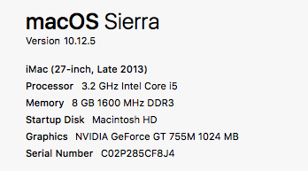

Are you running an older version of OS X?
Hi Marc, thanks for responding.
No I am using the latest OSX
I was using SU16 without any issue until I installed the latest patch
I am currently using the version below
Ok, that’s exactly the problem. SketchUp 16.1.1451 was released before macOS Sierra existed. When Sierra was released, we discovered this exact crash and we made a special mac-only maintenance release of SketchUp to fix it. This maintenance release should have exactly the same features & behavior as your current version except for this crash being fixed, so it should be low-risk to update.
