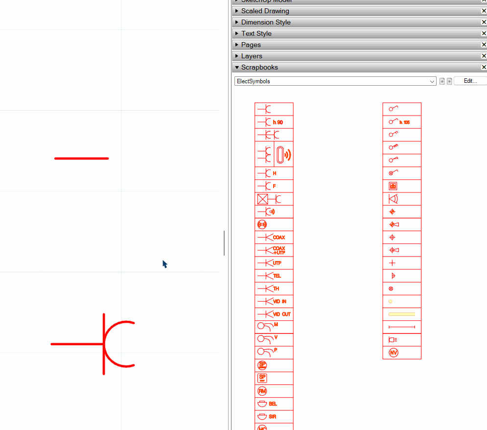

I’m having problems with Scrapbooks. LayOut collapses as soon as I remove an item. Why is this happening? I’ve never had this issue before and I’ve been using the template for a year.
What do you mean by “remove an item”? What kind of item and from where are you removing it?
When I take an item from Scrapbooks and place it on my workspace, LayOut freezes and then closes.

Scrapbook elektrische symbolen.layout (7.7 MB)
It doesn’t work on my desktop either.
That’s the scrapbook file? Are you wanting it to come into your document as a single object?
Yes, I used to be able to drag the symbols out.
It works for me although some of the symblols have been exploded so only a part of them will come in. Looks like you need to go in and make groups for some of the symbols.

They used to be grouped, but when I try to select the top one, everything freezes. I do indeed always work from my NAS.
Do I have to redo everything? I also can’t copy it onto a new sheet. As soon as I click anything, everything freezes. Or can I select and copy everything using my keyboard

FWIW, I would suggest splitting those long columns of symbols into shorter ones and making the paper size for the scrapbook page fit them tightly. That will allow your symbols to appear larger and easier to read in the Scrapbooks panel.
I went thought and made the groups. I also rearranged things so the symbols will be slightly larger.
Save this as a template into LayOut’s default location (not your NAS) and see if it behaves better for you.
ElectSymbols GROUPS.layout (114.2 KB)
Thank you so much for helping me. Unfortunately, it’s still not working. I can remove the symbol, but as soon as I try to edit it or select it again, LayOut closes. In the meantime, I’ve reinstalled my graphics card driver — it had just been updated — and I’ve reinstalled SketchUp. I’m now also working from my desktop instead of the NAS. The problem remains. I’m afraid I’ll have to recreate it.
