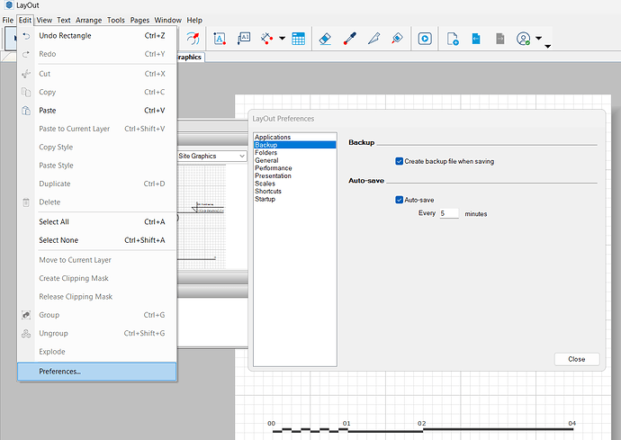

If you are still in edit mode, you can Revert to the last saved version:
If you have these settings checked in Edit > Preferences > Backup:
There is a backup with ‘Back of …’ added to the original name:

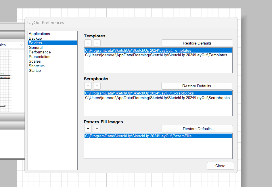

The shipped ones are in the Program Data, which would be erased when reinstalling.
It is better to add a common resource folder with your own scrapbooks, and add them to folders:
