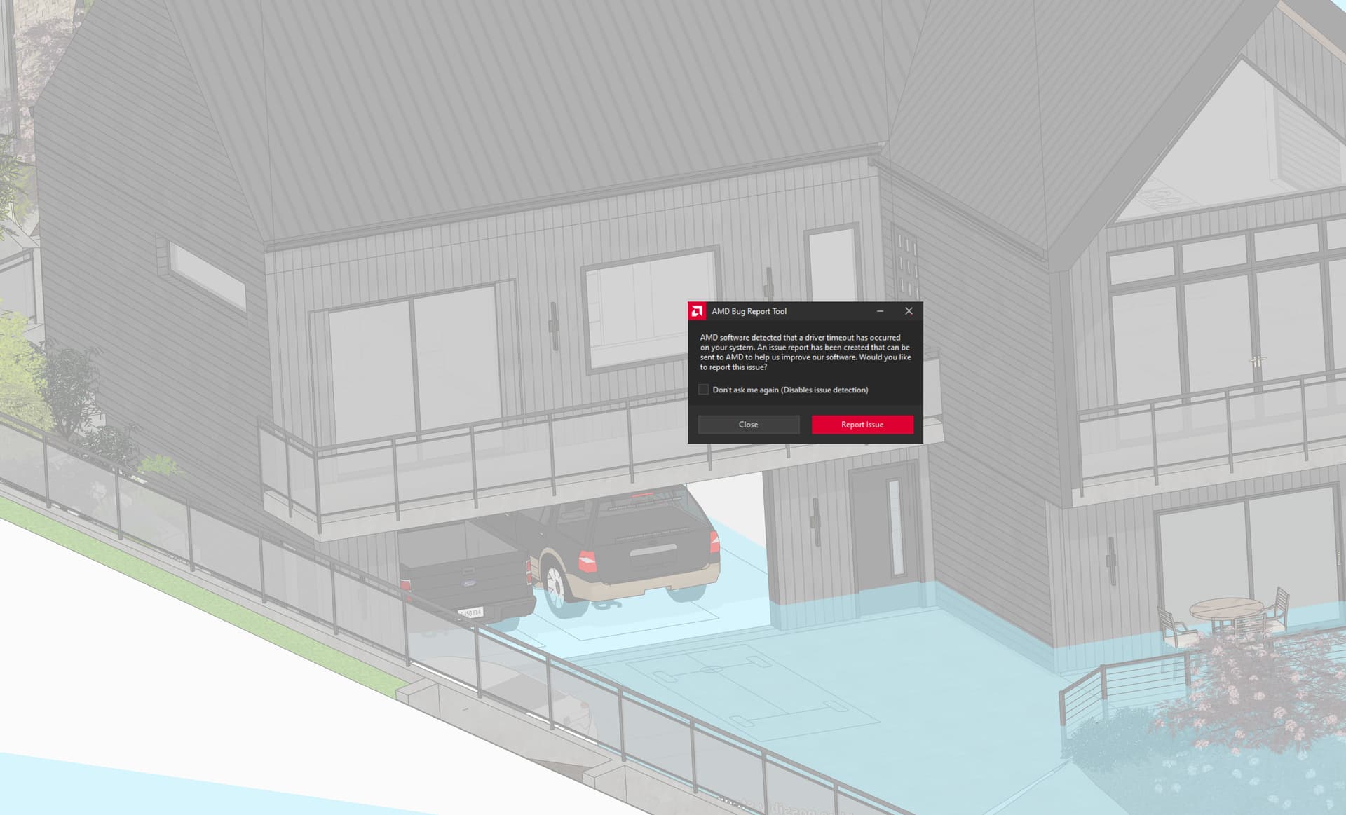

Hey Sketchup community! I would really appreciate some advice on my model and the landscaping I have in it. I think my polygon count is too high and my edge count as well. However I don’t know what to do as I want to produce high quality renderings of the geometry. I am familiar with proxies, 2d graphics and 3d objects. I am very well read and experienced with sketchup, but this landscaping thing I need some basic tips still I think… My graphics card for the first time stalled on me, on a great computer system, 64gb ram and blah blah, graphics card is rx 580 by radeon, good card, but I could probably get a better one and see a bigger performance boost… Anyways, see attached photo of my model polygon and edge count. The file size due to the plants and vegetation is around 80mb, you can see the photo for the model statistics on the rest.
Can anyone give me any best practice tips for finding or managing high poly vegetation? Is my poly count way too high given the plants and things I have in the model? I’ve inspected each plant before downloading and they render ok, good enough anyways, they also use components for a lot of the leafs and the leafs and stuff and faces of the plants are clean and simple to still produce a high quality render. I’m not sure how to get around this, I don’t think I could find better plants to be honest that will render great, must I be using proxies than or? Each plant I’ve downloaded here is around 3mb and typically like between 5000 to 40,000 faces, perhaps more with some plants… Looking on the 3d warehouse, I constnatly adjusted the poly slider to be around 10,000 and I just couldn’t find plants that would render well so I had to crank the poly count… Perhaps that’s maybe what I have to do? Not sure on this one… Any advice would be amazing.

18 million edges are way too much.
My advice is to ditch 95% of the high poly vegetation. Use good 2D face-me trees or 3D versions of them instead. Most 3D trees don’t even look good, and the repetition is ugly when they are used en masse. You can use single items for something that is seen from very near.
Thanks for the comment on the polygon size! Yea it’s insane how much poly these plants have taken up, even after trying to be careful. Regarding removing them, that’s not really an option as I want to have my sketchup model render into layout where I have some site plan scenes that need to show good enough looking plant geometry of the site in layout, that means I can’t just rely on a proxy… @AK_SAM could really use you on this question here too, how can I do both, layout and render ready? I can see how if I make simple objects for each plant as you do sam and as others mention to do, which I do for other things already just not plants, I can see how my model would be super fast, it already is when I hide the plants via differing scenes, but how am I supposed to manage some scenes when I have to load the plants into those scenes and do things to those scenes? Do I turn off sectoins of plants at a time while I’m modelling, I can only imagine a site with way more plants that I also want to show and look good in layout for the site plans and wonder how I’m going to do that… I think it’s probably about hiding most plants not being worked on while modelling when I have to load the scenes with all the plants?.. This landscape thing haha, real challenge.

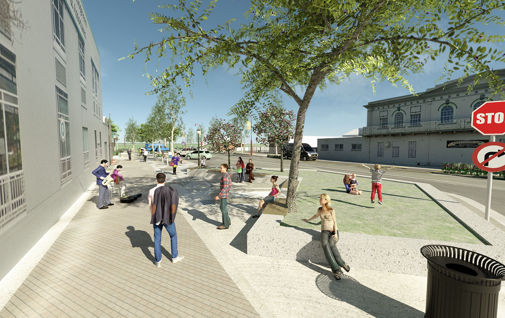

Here’s a quick shot of the street scene model. not really intended for close up rendering but did a quick export to see how it would look… the tree looks okay except the trunk is colliding with the seat! :stuck_out_tongue: (one of the pitalls of having 2d+3d components…the origin has to be Excatly the same)

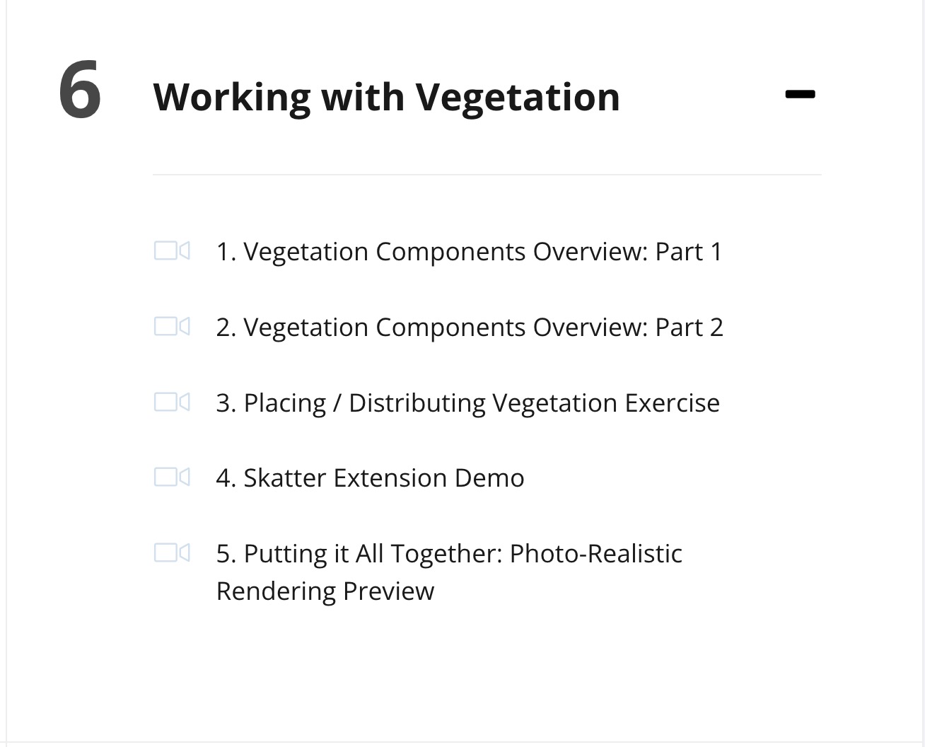

Have you checked out our course on SketchUp Campus yet? Specifically, section 6, working with vegetation.
