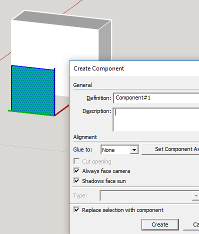

Many thanks @DaveR for your super-fast response. I’ve tried making it a component (it turns green and the pic disappears):
And then when I click on creat it collapses into a line:
What do you mean by “looking straight”? Maybe the problem lies in not doing so…
EDIT: thought you could mean that the pic is facing the screen. Then it didn’t disappear but still just a green rectangle…
EDIT2 It seems what made it collapse into a line was that “Replace selection with component” was checked.

The green color was due to the “displaying by color of layer” instead of by material… Now I can just pull/push the pic and it gets volume… Many thanks!!!
