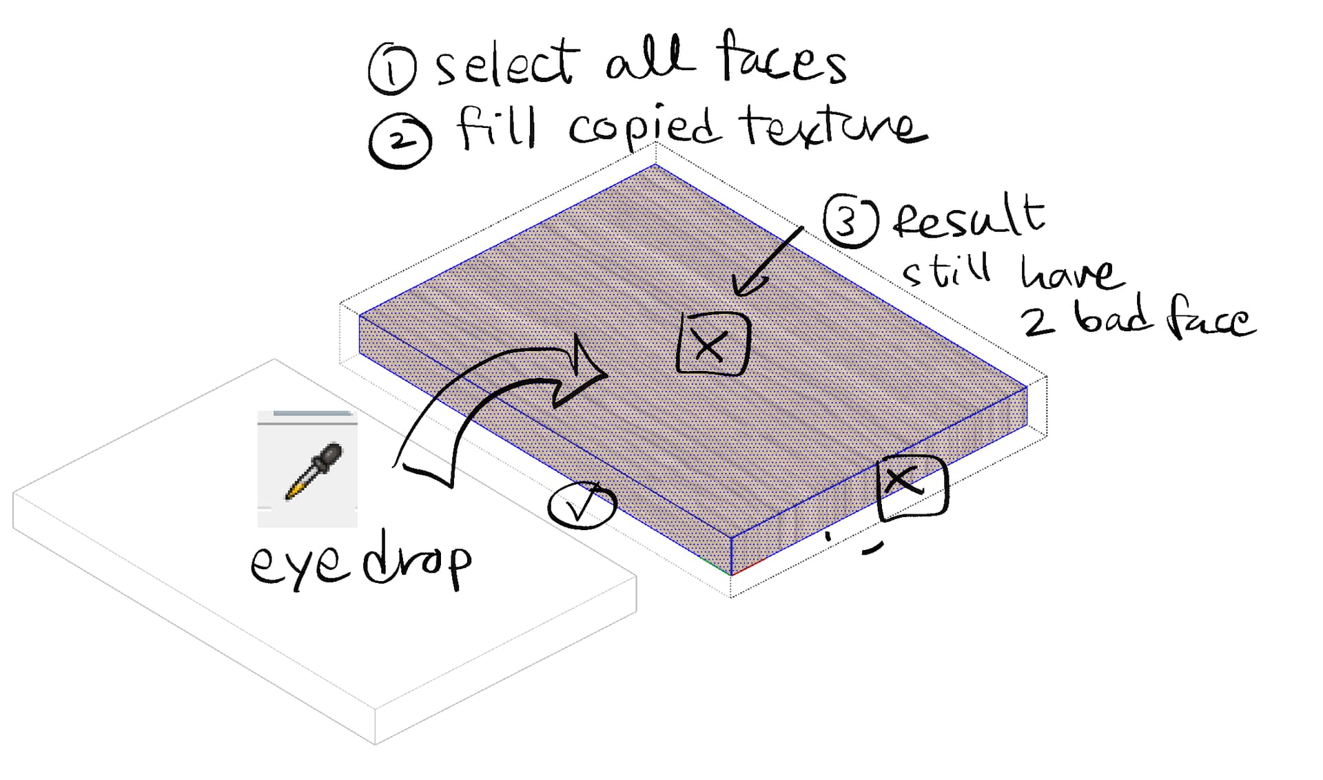

If the materials are applied to the faces you can use the native controls to rotate the material 90°. I do that for one face and the next time I need to apply the texture with that orientation I use the eye dropper to sample the rotated material. You can sample a material applied to a face in one component while another component is open for editing.

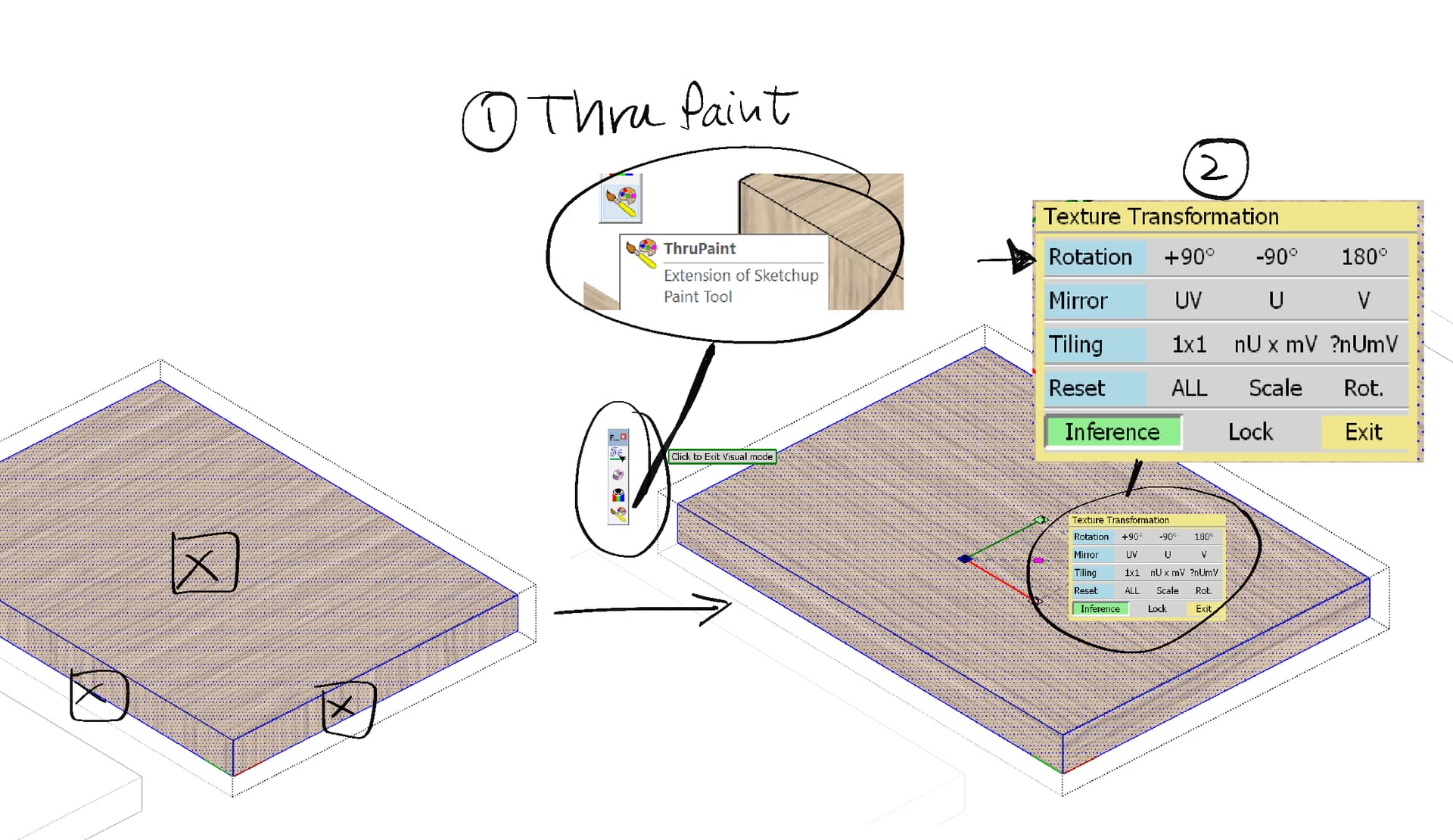

And if you must use a plugin, fredo’s Thrupaint.

I re-test eye dropper. It is only help a bit. I still need to copy from face to face.
Also we need to have one correct object to be reference to copy to another.

Also, Eneroth texture positioning tools. You still need to have the target face selected.
@Box Thanks for sharing.
Fredo Thrupaint may be a good solution.
I can quickly fix all faces at the same time from Rotation window.

Endlessfix
You change the way I work forever !
This is exactly what I am looking for. This should be a the fastest way to manage texture direction !
Thank you very much. :smiley:

Kwin, try s4u paint extension, you won’t even have to double-click to enter the group for editing and rotating materials.
Thrupaint also works through the wrapper, Probably Eneroths as well.
Thank you. This extension is maybe even faster without many double click to get inside component.
I will check it out.
Did you ever find an ideal solution? Using Eneroth Texture Positioning Tools I must enter the face context to rotate. Still, it’s a timesaver. s4u Paint free trial is giving an activation error… haven’t yet tried Fredo ThruPaint (free trial).
