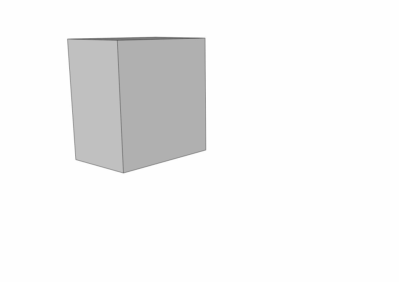

Many people are caught out by the Anti Z-fighting feature of 3d text.
If you place flat 3d text, meaning filled but not extruded, on a face SU cleverly positions it just off the face to avoid z-fighting. The down side to this is it isn’t touching the face if you want it to intersect.
Whereas non filled text will intersect with the face it is placed on. (you still may need to run intersect sometimes).
You can see in the gif even after intersect faces it still hasn’t cut the face.
Text off face
You can also set the depth by using a negative extrusion.
Neg extrude
