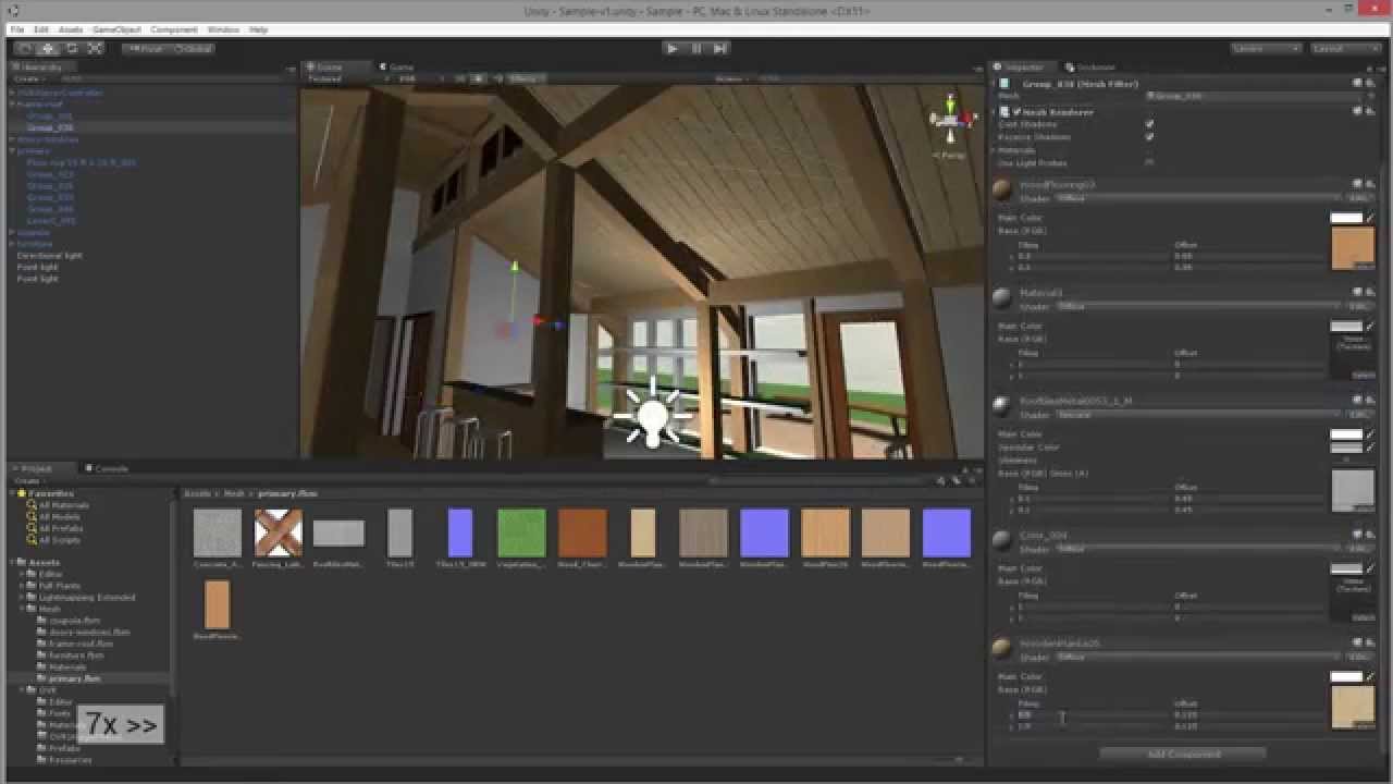

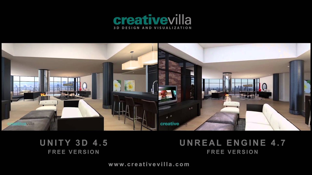

Here are a couple of videos that might be worth watching. The first one compares Unity 4.5 against Unreal 4.7, and Unity 5 has global illumination, which helps a lot. The other video shows someone’s workflow from SketchUp to Oculus. He goes via 3D Studio Max to improve the textures, and is using FBX. I think you could go straight from SketchUp to Unity using Collada.
