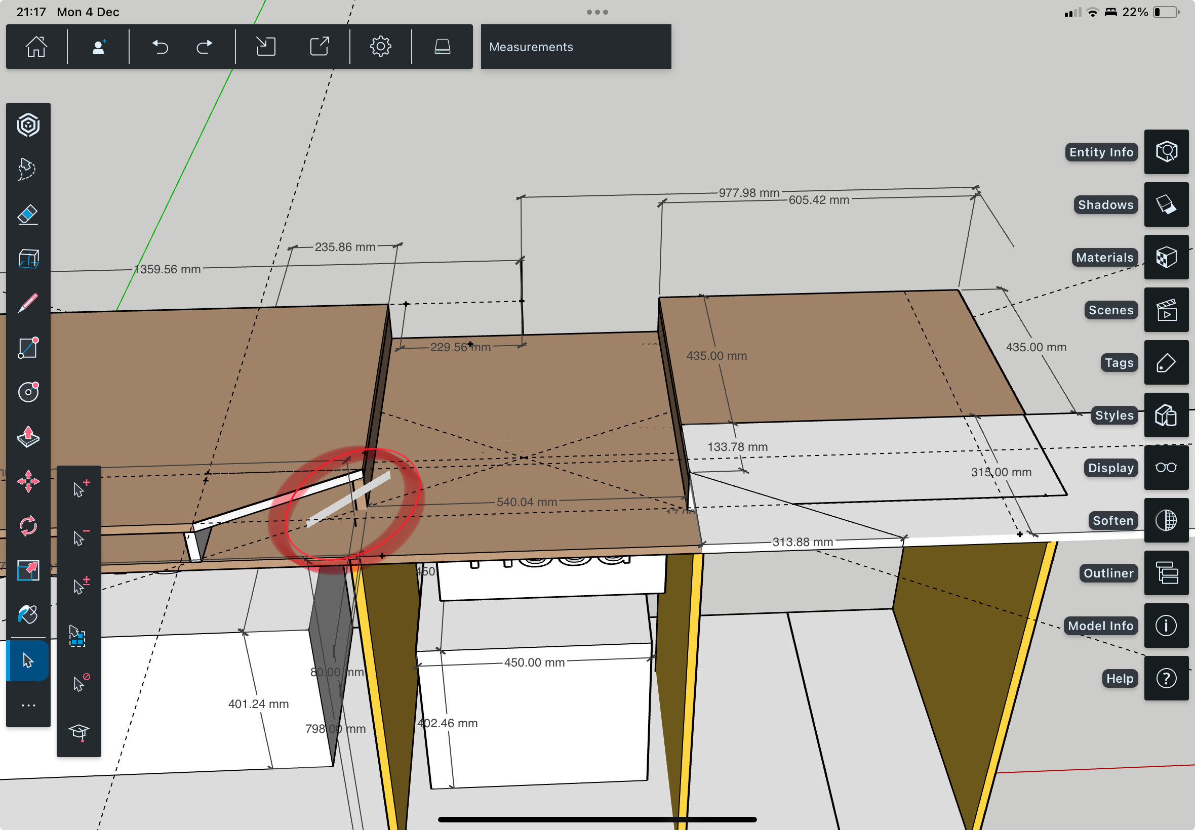

I have erased a cut off section but the infill remains on the image. The only way I can get rid of the bulk of the unwanted image is to use the push pull tool which remains active even though the wire frame is erased. A un-erasable plane stays floating on the drawing. Any help on how to get rid of the ghost plane? I’d attach an image or link if I knew how to.

I could see it. It is loose geometry. I triple clicked on it to select it all and then deleted it.
For the other corner I opened the group and used Push/Pull to lop off the unwanted bit.
You wouldn’t want to just delete it because you’ll lose stuff you need to keep.

I’ve highlighted the hole in this group that I’ve tried to undo but remains. I’m guessing it’s all the same erase issue that I’m having

How did you go about creating that in the first place? The edges are hidden. I was able to unhide all of the edges and then select and delete the faces skinning the hole and the excess geometry.
To make a hole like that you should be able to just open the group for editing, draw a circle on top and use Push/Pull to p[ush it through to the opposite side to make the hole.

Thanks DaveR. In the group I drew the hole, push pulled - standard basic procedure. Undoing or repairing it should have been straight forward erasure. Yes I tried doing exactly what you said but it didn’t work so, as you can see, I ‘skinned’ it top and bottom then erased the lines. Unsatisfactory. Gotta go but thanks ever so much for your help.
Getting rid of the hole is as simple as opening the object for editing, selecting the geometry and deleting it. I’m not sure how you got it but there was a fair amount of excess geometry around and across that hole.
Select and delete.

Yup. That’s what I usually do, but (for me) it didn’t work this time. Too much (old?) geometry
Maybe not the right selection. I don’t know what you did but there were a bunch of hidden edges in some of the groups.
Yes. Carelessness in the design drawing stage. Thanks so much for your excellent help.
